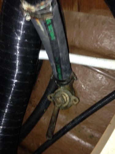

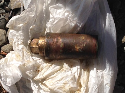

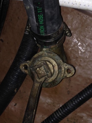

Here's a photo update. Daniel is correct. This is a large seacock under the head sink, but outboard of the sink on the starboard side. It seems to be the same size/configuration as the water intake for the engine. As shown in the picture, the barrel (from the engine seacock that I've pulled) is slightly tapered--you were right Daniel. It's also approximately 1-3/8" OD at the smallest end. The opening for the flexible hose is quite large. The OD on the hose is approximately 1-3/4"

I'll try Daniel's quick heating method to see if I can loosen the barrel on the stuck seacock. The others aren't scored, so I'm hoping that this one is ok. Hopefully, some grinding paste will get me back in business. Otherwise, I'll have to figure out a plan B.

indeed the picture displays a precious and classic Blake! I would insist with the push-from-outside method and, of course, some heating of the seacock body may help. An additional preparation would be closing the outer port with a cork and pouring into the inner hose port penetrating oil or vinegar up to the rim and let it work for a while; this is what I would do.

By the way, I thought Daniel's idea of using apple vinegar as a weak acid was brilliant. I plugged the hole and filled the seacock with vinegar for approximately 20 hours--nothing. I then tried my own blend of penetrating oil (30% acetone, 70% vegetable oil) for 20 hours, and finally Kroil (a top end commercially prepared penetrating oil) for 20 hours. When I tap (or rather 'whack hard' with a hammer) from the outside, there is absolutely no movement. For what ever reason, the until corroded enough internally to weld together. So, it's time to admit defeat and move on to replacement.
