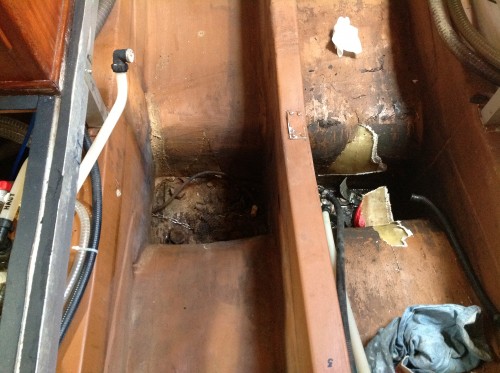

The flexibility should show up by now as damage if not remedied.
Pictures of the floors in the bilge would confirm if remedy done or not, but this area is not immediately accessible. The deepest part of the bilge under the battery box would be of interest.

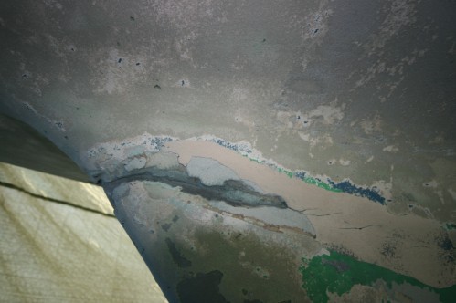

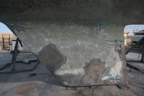

i have this kind if problem , but i do not know what to do
when i pull the boat every year i have a crack between hull and keel ,and i also have crack under the battery compartiment , and under tanks
i think this is coming of a bad connection with the inside floor support and it does only affect the very light polyester?
all keel bolts have been checked last year
i inted to reinforce the hull at the lowest part from keel to one meter on the top with epoxyand fiber, but if i could get good info it will help

crack inside
junction in the front
junction in the back
