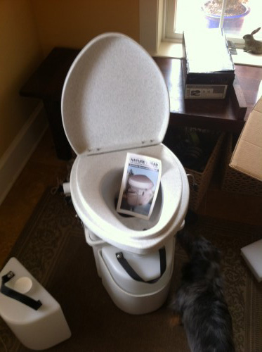

I just received my new "Nature's head" head and have a copuple of pictures to show you.  Some have asked about this type of head and i will happily report back after installation and use.
Head Top view

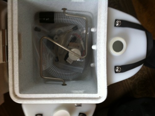

Head Inside View with parts

Hi Florence,
I think the best way to get information is to do a google search for "Nature's Head." Many sailors have been using these toilets for many years; the search I did was very informative and provided me with answers to most of my questions.
Cleaning the solids box: not recommended since cleaners can destroy the bacteria necessary to compost. Suggested that a plastic garbage bag is placed over the top and the solids, by now dessicated, be tipped into the bag.
A 12-volt fan is attached to the side of the solids container which, in theory, helps removed the liquids. A hose is attached and run through the deck to a mushroom vent.
As you can see from the pics, the liquids and solids are separated; the liquids are directed to the bottle which holds 2.2 gallons. I have an extra. These can be taken ashore and dumped into a conventional toilet.
No through-hull necessary. This type of head is ideal for weekenders and those who take 1-2 week trips. The longer the waste remains in the bin, the more dessicated it becomes. However, I have read about many live-aboards who have had success.
I hope this helps. I plan to visit the boat next weekend and will measure then to see how much modification is necessary.

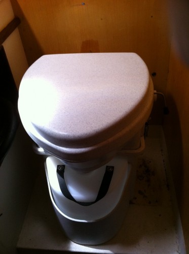

The Nature's Head fits in the location of the original toilet.
Head Fitted but not Mounted

It fits well into the head compartment.

Thank you. Yes, a good fit for the time being, however, since there has been so much water damage and because I no long have typical head plumbing, I will likely make modifications to the head compartment - but that's another job for another time!
