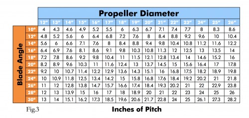

Hello all. I own Zeevogel, a Swan 1971 43' hull 49 out of Vancouver, Canada and I've just bought a new Max Prop Easy 18". I have a Perkins 4-108 with the Borg Warner transmission with a 2:1 ratio - has anyone had good experience with setting the correct pitch to gain hull speed (approx. 7.4 kts) between 2200-2400 RPM. Perkins told me that's the best RPM range to run that engine at and Max Prop (PYI Inc) has recommended a 11" pitch (18 degree set screw on the Easy prop)- the next degree/pitch up from there is 12.4" which is a 22 degree set screw.
The new Easy props can be set underwater which I could do but I would like to get it right if possible before I drop her back into the water. Wisdom welcomed.

PYI's pitch chart

A pitch recommendation can not be given without reliable data.
For sailing yachts the 4-108 rating is 37 hp/3000 rpm, this means that at 2200 rpm 15 hp is used, and at 2400 rpm 19 hp.
19 hp produces about 7 knots, and you aimed at 7.4, for this higher rpms are required, about 2700, using 27 hp.
This is the same rpm you used before for cruising at lower speeds, it is obvious that the 2-bladed Max-Prop had too little pitch.
The minimum speed is related to the pitch as you assume.

Sorry to get back so late on this. I've had great success with 11" pitch with the 3 Bladed Max Prop Easy. I'm getting 6.5kts at 2200RPM and just over 7 kts at 2400 RPM. At 2600 I'm getting full hull speed even in a 1.5 current. It's a very smooth prop / no vibrations overall and with my new Isoflex engine mounts I'm very happy and would recommend those mounts to anyone with a Perkins.
