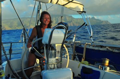

I can notice on your pictures that you have inserted the life-raft in the cockpit, close to the helm. Sounds like an interesting idea.

Thank you for the fair winds Christophe. The liferaft placement was one of those "small Swan" compromises. We wanted it to go into the cockpit locker as designed, and we did for a while, but the valise weathered so badly there, that we got a box for it. There was also the question of where to store oil, varnish and thinner. We now store them in the cockpit locker. The liferaft would not fit forward of the spray hood as we have a rigid vang. With our tall ladder, down in the cabin, on top of the engine box was out of the question. So, with a heavy sigh, we put it in its not very beautiful spot. It is not pretty, but functional. We can get to it, and my wife does not have to lift it. Since there are only two of us on board, the cockpit space is workable. And my Amel friend meant no harm. But yes, he enjoys his comfort. Lastly, if anyone has an idea for a more elegant liferaft solution, we would appreciate hearing it.
Thank you in advance, Rod and Elisabeth

Have you considered mounting the life raft box on the aft side of the pushpit?

It is an honour to "speak" with you. I am afraid our pushpit rail is perhaps too occupied. We have a Wind Pilot vane steering on the transom, radar pole, wind generator pole, and outboard dinghy engine on or near the rail. We also have not found a suitable place to store our stern anchor, and thought the pushpit might work. So far, we still keep it dismantled stored below. I am attaching a photo of the boat so you can see our condition. The outboard is not mounted in the photo. (on the dinghy). Another consideration we have is that with all the gear we already have back there, we worry about getting the boat in too much aft down trim. She still sails beautifully, but we don't want to push our luck. We both thank you for having a look and offering ideas. Rod and Elisabeth

Another possibility would be in a cassette inserted through the seat front opposite the present locker.
Needs to be checked that the raft can go in through the opening, considering that the cockpit well is rather narrow, and that this does not intrude too much into the interior. The bottom of the cassette should preferably slope some 5 degrees towards the centerline, so the recess drains when the yacht is upright

We believe that you have a great idea there, and we may consider it for the next time we are prepared to do major work on the boat. It is evident that the measurements would need to be taken carefully as it is narrow, and we do have our autopilot under there. It would be a fairly major job, so it would need to be done right – both from an aesthetic as well as a structural point of view. We both agree that for someone who is currently outfitting, this could be a good solution to a sticky problem. Well worth considering. Then one can keep one's cockpit table! Unfortunately, we had to finally say good bye to ours in Mexico.
