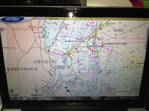

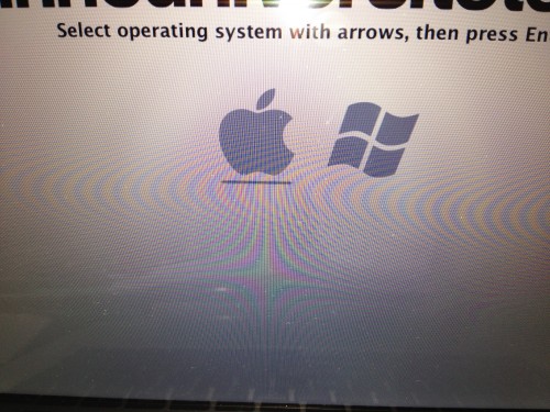

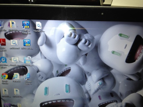

Some comments on the Mac vs. PC: The mac is superior without a doubt. It is stable, secure; it has an excellent graphics and a friendly interface. I use to work PCs on my boat before but I got tired of all the stupid configurations problems "invented" by Bill Gates, especially on the infamous Vista. So I changed to the MAC. I have been so problem free since that I would never consider any PC whatsoever; and believe me, I am a heavy user!
So, as to using the charts software in the MAC, yes, you can do that. The MAC has the so-called BOOTCAMP through with you actually can divide the partition of your hard disk in two portions: one for the Mac software and programs and one for any Windows based application. So, you can actually load Windows (I recommend version 7 and not Vista) on the second half of your partition. Then, you can load any Windows based software there including the chart software. In this very manner I run MAXSEA on my Mac and it works like a dream! So, go ahead and bring your beautiful Mac air on board.
AS to the Raster vs. Vector charts, well, the Raster are simply a copy of the paper charts whilst the Vector are mathematically build with layers of information. It means that you can choose to reduce the numbers of layers depending on what you want to see in terms of information on your chart. There are advantages and disadvantages with both. Personally, I prefer the raster format because they are the exact representation of the paper charts.
Cheers//Philippe
(Farouche 47/50)
Here are three pics: The first showing the Mac booting and giving the choice of two operating systems. The second showing the Mac displaying the Windows 7 page with the software Maxsea on the left hand corner. The third pic shows a raster example. Details on the chart can increase as you zoom in.

Dear Chris,
The point that raise about the readability of the screens of the computers in the cockpit is tough one. Alas, I must say that even the excellent Mac does have a shortcoming in this respect. For my part, I use the Mac on the Nav table only. In the cockpit, I have a chart plotter Lowrance. Its readability is more than excellent. At the end of the day, I then have two independent systems - perhaps a little laborious but very convenient: the Mac with Maxsea on the nav. table and the Lowrance with Navionics in the cockpit.
Cheers// Philippe
