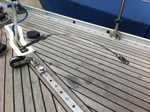

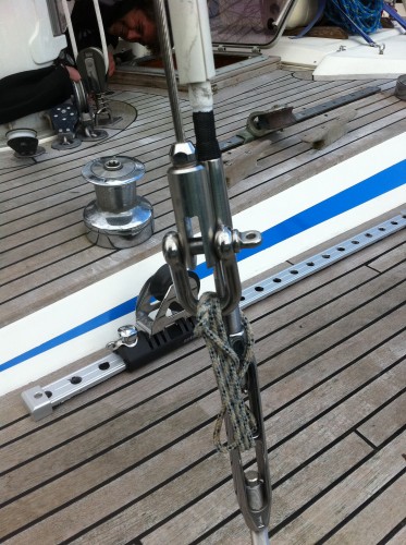

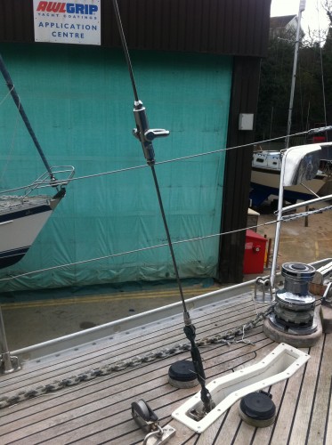

Join Date: 01 March 2007
Here are some pictures which I hope shows what we have tried to achieve. The idea was to make a break in the stay which allowed a shortened stay to be stowed by lashing against the turnbuckle on the forward shroud. The photograph shows a temporary lashing to demonstrate. I wanted the stay to be away from the mast and not interfere with a tacking genoa. The forward shroud seems the best point. To set the stay means simply re-joining the longer tack end which includes the turnbuckle.
21 February 2013 - 23:18
#27
The compromise I have made is that now the hanked sail does not fall completely to the deck, but releasing a couple of hanks soon sorts it. Leaving the sail hanked on and in a bag is not quite so straightforward.
