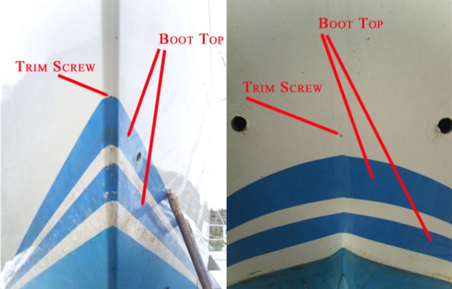

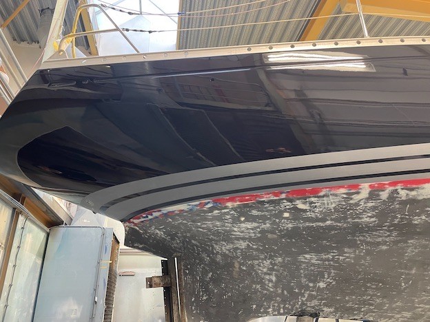

Dear Carl,
yes, all later S&S Swan (some of the early ones, e.g. 36, 40... had just one)  had two stripes, and they have a specific shape.
If the bottom stripe has been covered with antifouling it means the boat is too heavy and not sailing on the original waterline (there should be two trim screws on top of the designed water lines (DWL), and designed floating should be 12 inch. lower, honestly a goal quite impossible to get when the boat is in her cruising mode! See below pic).
There is a document among "technical papers" on how they should be properly drafted, if you are unable to find it please let me know, I will send it to you.
Trim Screw on S&S Swan

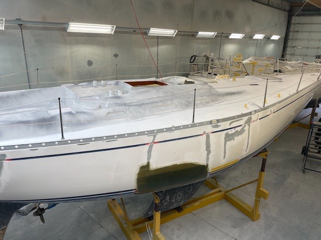

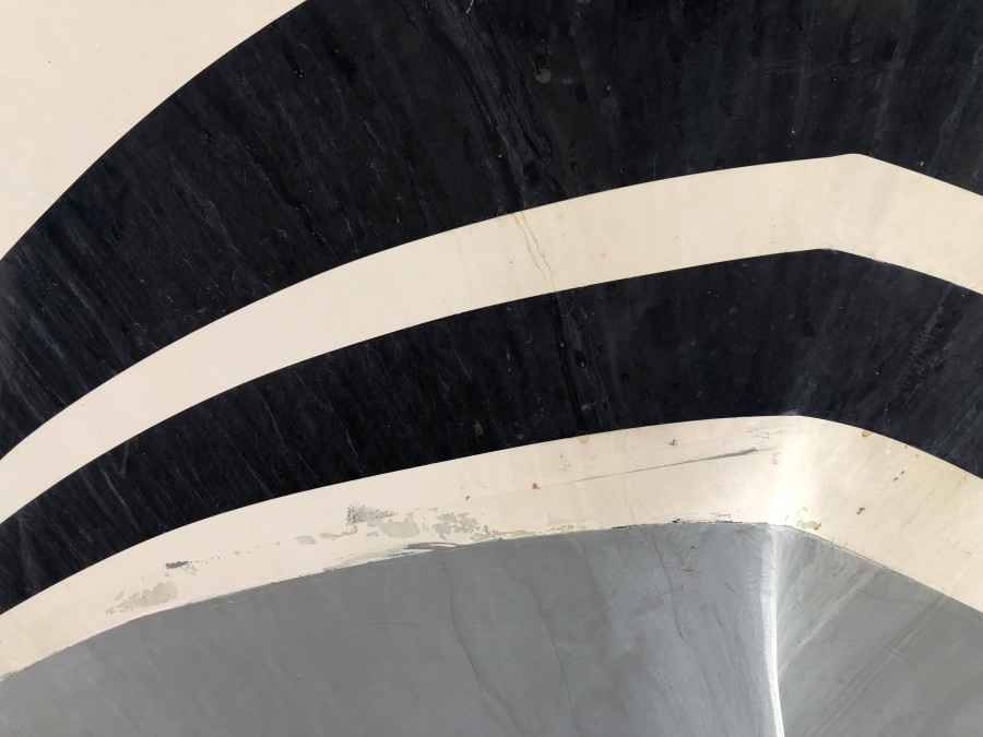

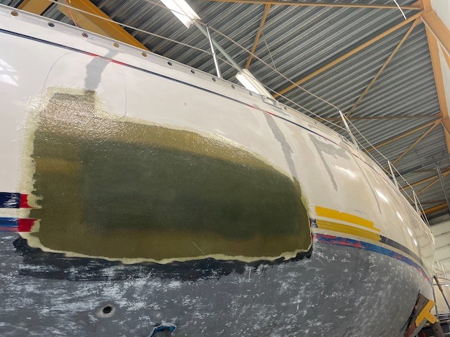

Hereby a short update. We discovered some more extensive damage in the laminate of one of the topsides. Nothing to worry about but here you can see the repair. Otherwise, all other spidercracks have been fixed and in the coming days Galatea will be made ready for painting the topsides (Majestic Blue). Boot tops will be white. Just not sure about the 'Swan stripe': either white or gold... what would you guys do?
Best regards,
Carl (Galatea - 41/010)

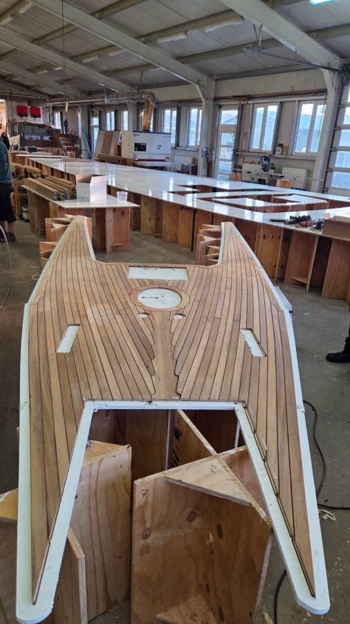

Hereby an update on the progress made. First of all a video update from the yard: https://youtu.be/I1pjG6ygFKI?si=XP9qv5Xn_77ODtuJ

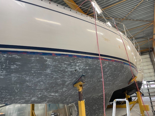

Since the video, the topsides have already been painted in Majestic Blue. Furthermore, the teak deck has been 'pre made' and will be placed around the first week of January. After that, rest of painting will be done. Please note that the boot tops are still in primer as you can see in the picture, these will be made white later.
