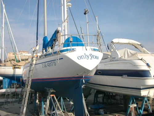

Hi Federic, my boat has just been re gelcoatted (look at the pic below). If the job has been done properly (I had the original Jotune product sprayed, then polished, 800 - 1000 - 1500), there is no reason why it should not last for another 31 years....
Awl Grip is more brilliant, but be sure it is not going to last for more than 10/12 years.
Fair Winds!
Matteo (38/067)

I agree with Philippe that the 411 in Seattle looks fine and I think that the price is quite good too. I would also consider seriously what he says about sailing back home: buying there is fine and I would do it, but sailing around the world is a totally different story. Just add the sum you need to have her shipped back home and consider if the price is still convenient; it is probably so even if you do not deduce the price you would spend to sail her around the world. Regarding the other boats available in Europe and the gelcoat/awlgrip issue: I once talked to a serious surveyor who told me that if the work is done properly gelcoat is better than awlgrip.
