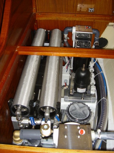

Stefano installed the same W/M I have onboard Only You, a 36 ltr per h. by Shenker (cfr. picture below. If you are intersted we bargained special discounts for S&S Swan Association Members), inside une of the saloon locker (left), it's the perfect location as it is right under the water tank.
It's up to you if it's worth it, for example me and my wife don't like to go into marinas when cruising, so it's fantastic to have plenty of fresh water onboard (we have a dog, a swimming dog, so we have to wash it every night, and believe me yoo need more water to rinse a dog than yourself!)
