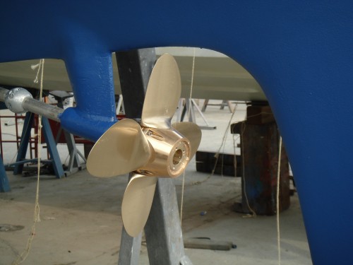

Dear S&S Friends,
the improvement I experienced from the three to the four blades prop is the great reduction of vibration (consequentely of noise). In addition this modern German designed Vari-Prop has the possibility to be setted (separately rev and fw) from underwater, you can get a very fine setting by just turning a screw, which is very practic and comfortable. On the even good Italian Max-Prop (which does exist in two or three blades only) you are forced to set the pith by a degree to the next or previous one, and not infinitely.
Recomended!
Matteo (38/067 ONLY YOU)

We are currently in the process of putting a new engine into our Swan 38. I was interested to read about your new propellor. I am thinking of getting one. We did have a 3 blade vari-prop but it did not have enough drive to our liking. Are you pleased with your four blade? Does it improve your power and performance especially manoevering and in a choppy sea?

Dear John,
my new VariProp is 15"
