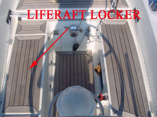

Hi everybody,
does someone of you have a liferaft stored  in the dedicated locker in cockpit onboard his S&S Swan 38? Which model is it?
Many thanks

bfa-PACIFIC for 6 pers. in a bag will fit perfectly. The size is 75x35x35 cm (LxWxH). Weight is between 30,7 and 24,5 kg depending on the equipment inside. (Standard or IOR/ORC). The bag is round so that it fits perfectly into the half round bottom of the locker. Distribution per today is via Zodiac Marine, so best would be to try their website. Do not hesitate to mail if you get stuck!

We do store a 6-man offshore liferaft (BFA Baltic-Sea model German manufacturer) in the locker. bfa Marine GmbH Austrasse 35, 86153 Augsburg, GERMANY.
