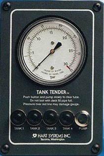

Fuel consumption for BUKH DV 24 ME, at 3.000 revs is about 2.5/2.8 ltr./h. You can get Tempo electric gauge from westmarine (2007 catalogue pag. 610) or, better of all, you could buy a Tank Tender unit, never fails!
