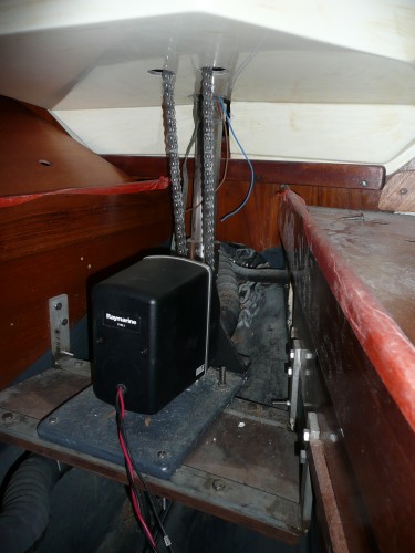

I had an American autopilot, Alpha, installed belowdecks, under helmsman seat near quadrant and there has been no problem with finding room for it.

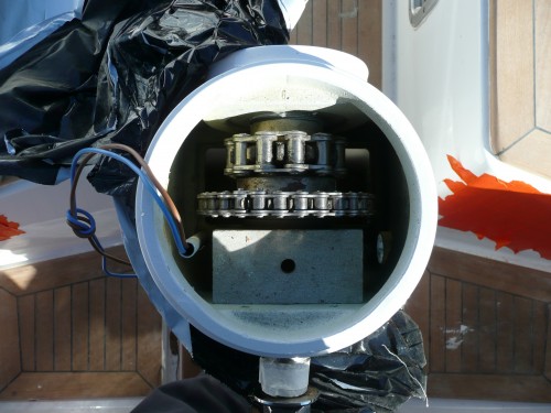

no need to build a n arm, engine is rotary driven and connected to wheel mechanism with a chain (model Raymarine ST6001 - Computer S2 - engine T1).

attached is a pic I took this morning of my Raymarine rotary engine, connected by chain (see above pic) to the wheel.
I'm very happy about this very simple and strait solution

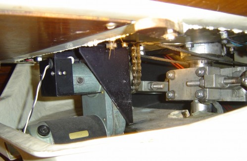

On our Infant we have a basically similar system as Matteo on Only You. It is an old Cetec Benmar CS 21 R installed under the bottom of the cockpit. Works fine. Regards, Jyrki
