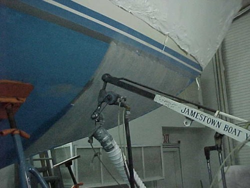

My Swan 43 (#46) went through a similar process of osmosis treatment below the waterline.  Although my boat's laminate was in very good shape with no blisters or de-laminations the mositure readings were on the high end of the scale.
Before the osmosis treatment could be done properly the gel coat and first couple of layers of laminate were mechanically peeled.  This was followed by the boat's laminate force dryed in a shed with infra-red heaters going for approximately 3 weeks non-stop.  After acceptable levels of dryness was achieved the the osmosis protectives were applied.
As noted by the previous responder, do not rush the process.  It should be done correctly following the osmosis treatment manufacturer's recommended guidelines.  You certainly do not want to have to do the osmosis treatment.
I have attached a photo of the boat during the drying porcess. Good luck

on our 41/022 we did a complete osmosis treatment some 25 years ago. It has been OK until now with only a few blisters in one place or another. Now it is starting again in some places so will have to be redone.
The only point we missed was to make sure that peeling the hull and subsequent painting was actually done ABOVE the waterline, and NOT ON the water line. As most of our boat are getting heavier than originally,  it means you must peel, and paint up to the second blue line, or even better INCLUDING the second blue line. Which is not what can be seen on the picture included in this link.
