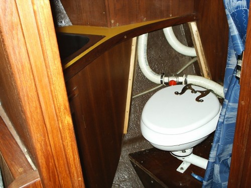

Hi there,
We have had several problems with our BB Head. My flushing pump keeps getting stucked... We were somehow getting used to it, and everytime it stopped functioning we opened up all the system for cleaning it.
Last time we were cruising for a couple of weeks when it stopped working again. I opened it and cleaned the systems but it wouldnt start. I tried to use some sand paper on the rubber parts for I knew that the past owners never changed them and they were visibly expanded, but not even that worked when I could see they were better.
I had to change the head for a new chinese model I had "in stock"... awful. Now I'm waiting for a new Jabsco Head to arrive from WestMarine. But my idea it's to fix the Baby Blake. Does anyone know what to do? I've asked the company and they told me to change all rubber parts, but as I said, they fit already but the pump still won't go on.
Also, should I install a second head? Another 431 in Chile's got one in the bow comparment, inside the middle chain's crate...
