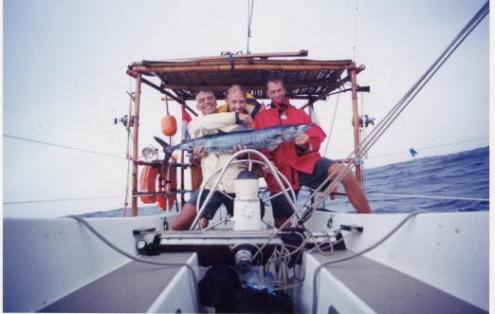

I found the picture I remembered of a boat like mine-S&S 40-showing a sun awning. It was taken in the Indian Ocean.
