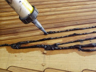

Dear Philippe,
as far as you know, did the shipyard degreased (e.g. with acetone) and  use the correct primer before getting the Sika 290? the problem you are facing let me think they did not, or that they got the Sika in a humid weather...?
Look at tha attached pic, it shows the prepared teack deck (cleaned and primerized) and the following process of the Sika 290.

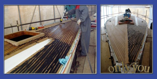

26 May 2008 - 19:51
Dear Daniele,
OK, I will try to explain my experience, even if I am not at all a professional:
1) after the deck has been laid down (mine was not screwed, just glued with 3M 5200) the whole deck must be carefully (CAREFULLY) cleaned and degreased (acetone is great, anyway Sika has a dedicated product).
2) it is absolutely compulsory to use a specific (Sika) primer before you are caulk, and you must wait no more that a few (betwen 15 minutes and 5 hours) hours before to pour the Sika 290.
3) Sika tells you you can cut the excess material after just a few days, my shipyard preferred to wait about three months.
4) the finl step is a very soft sanding (I asked the shipyard not to sand my deck, as I am not interested in the beautiful tan colour, it is destined to last for a very short period of time, but takes away a few microns (or mm) of good wood!
5) I think the same procedures must be carried for old wood too, but be careful as you cannot mix different kind of caulking, and I don't think Nautor back in the seventies used Sika, hope Lars Strom will let us all to know which was their product.
Attached is a pics of two step of the work done on Only You deck, on the left you can see the deck prepared with the Sika primer (November 2007), on the right, half of the excess Sika has been cutted (February 2008)
Fair wind!
p.s. the plastic was hust to cover the deck during the awlgrip spraying
