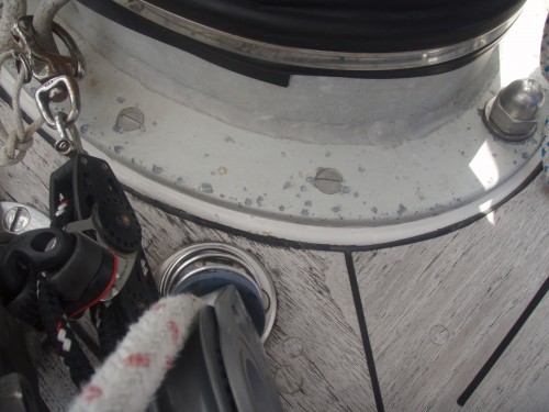

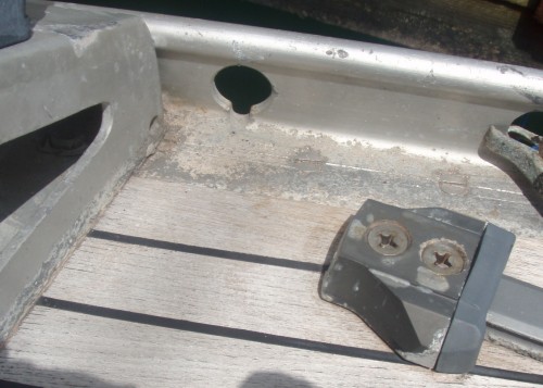

Hello All:
Please see the attached pics and cast your opinion. I appear to have some pock markings on various places of our boat (port lead car track aft end, but not on starboard, boom, base of mast). Is this electrolysis or something else? I have asked some of the local people here in St. Thomas and opinions vary.
What type of a professional would I approach for help with diagnosis and treatment? Marine electrician, general handyman, rigger? Of note, our boat took a near lightening strike last September and sustained significant damage to navagation and electrical equipment. We replaced a lot of our equipment.
Initially, I thought this might be just 'wear and tear' on the boat, but now I am not so sure.
Thoughts or comments from Europe?
Cheers,
P Milo

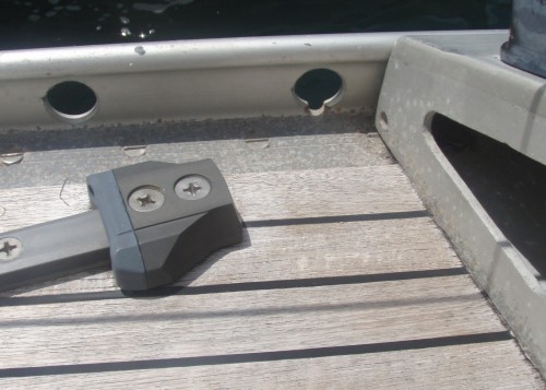

02 June 2008 - 21:17
Join Date: 26 March 2008
Posts: 69
Starboard aft end of lead car with no damage.
Milo

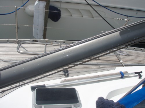

02 June 2008 - 21:18
Posts: 69
Boom Vang with pock markings.
Milo

05 June 2008 - 20:02
Dear all
I would suggest the first picture shows the effects of some very strong chemicals, maybe a teak conditioner, which has destroyed the anodizing layer locally, and left the aluminum surface bare. White aluminum oxide will then form on the surface. The unprotected metal corrodes very slowly due to the presense of seawater.
Another type of corrosion is denoted galvanic and may occur for example in the toe rail around the stainless bolts. The nobler metal is stainless, and when both are immersed in seawater the aluminum will work as a sacrificial anode, and is eaten away while the stainless remains unchanged. If the two metals are not  in electrical contact with each other galvanic corrosion does not occur. For this reason newer Swans have plastic washers under the toe rail bolts. These washers can be bought from Nautor spareparts, but they are intended for Allen head bolts and not slot head bolts, the geometry is different. There is another way to prevent galvanic corrosion between the two metals - introduce a third one which is less noble than aluminium, for example zinc. By putting in zinc anodes for each bolt the aluminium will not suffer but the zincs.

06 June 2008 - 00:29
Join Date: 06 June 2008
Posts: 6
Lars,
Thanks for adding some clarity to "corrosion"
Now, would your opinion of the first picture change, with the additional information that at the time we noted the corrosion, the rail had been in and out of the water for hours, and when we pulled out a voltmeter, we noted 12v differential b/t toe rail and lead car track.  couldn't find any obvious electrical leak, but voltage disappeared when we turned off one of the breakers on the main control board (theoretically, none of the electrical work recently done on the boat had involved anything on that circuit)
When we checked for voltage later between the two, with and without the breaker on, it was no longer there.
SOOOOO..... if electrolysis--how do we track down the source??
forgive any misuse of electrical terms--clearly this is not my area of expertise!!
thanks for any help
jill
06 June 2008 - 13:12
Jill,
a 12V difference between toe rail and lead car track is quite bad news indeed.
Next time it happens, you should note which is the positive part; all metal parts of the boat are supposed to be connected to the negative terminal of the battery so a positive voltage will narrow the search of the culprit and make the solution easier.
Daniel
06 June 2008 - 18:57
Dear Jill
Yes, the corrosion could also be caused by an electrical leak.
The sheet tracks visible in the pictures are not original, and it is possible that in connection with the installation of these tracks an electrical cable has been drilled through somewhere below deck, and feeds a voltage into the track. 12 V indicates a very good connection, but a continuous leak should cause the wet teak deck to turn black in the affected area - have you noticed such tendencies?
By turning the circuit switches on one at a time, and measuring the voltage between toe rail and sheet track you should be able to locate which circuit is suspect. Inspection of the deck underside in the sheet track area would also be necessary for finding out if the track fasteners are involved. If you can see some lighting cables disappearing into the deck core they are highly suspicious, because they are not visible when drilling.
Daniel, Perkins engines originally have insulated return electrical systems, meaning negative pole is not connected to the engine block, but the system is easily upset by later installation of components having negative and ground connected. Insulated return reduces the risk and effects of electrical leaks
The toe rails on older Swans are grounded, the reason was the radio direction finding systems used for navigation at the time, this improved reception.
