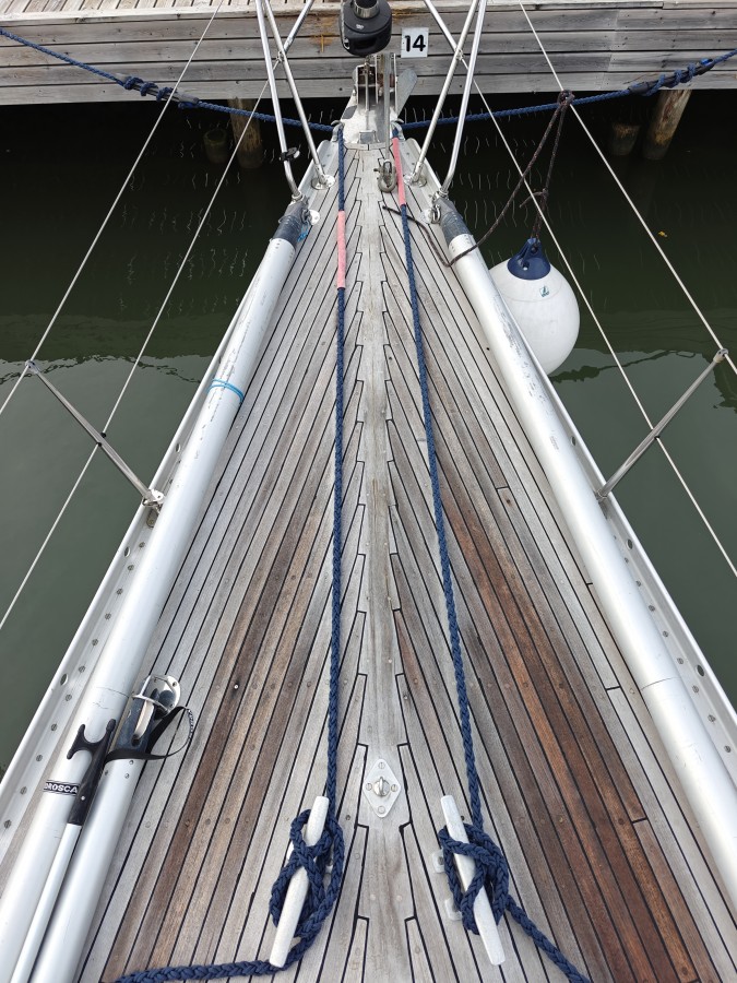

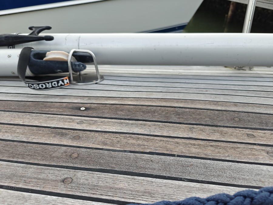

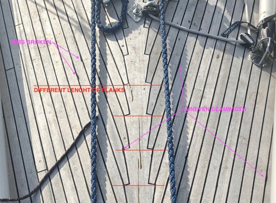

Hello,
what a nice and warm weather it has been here in southern Finland. Today we lifted Pampero to a safe boatyard for winter.
During the last two weeks in water I noticed that some small parts of teak deck had been blunged up. All the sealings were still in place but it somehow seems that attachmend between teak and deck is separated...
Is it possible to fix these issues without removing the whole teak deck?
Does teak dry (fully) also underneath if it has not been saturated/coated with teak oil etc. ?
She has been sailing in the Baltic Sea for all her life so salty waters don't put load on the materials so much.
I'd appreciate if someone has any ideas. I can also send more pictures or share dropbox if it helps? There are more photos over this issue.

As a Swan enthusiast i've been enjoying this forum for years, but as an RH Swan owner i've been hesitant to post before. That being said, as long as the moderators approve, i could offer a few thoughts.
The teak deck is glued and screwed onto the boat. Based on your pictures, the glue could have lost adherence. You should be able to figure it out by tapping the deck, comparing the sound. I notice a screw missing a bung in the second photo. The wood around the screw looks dark. Could this be the leak that caused the failure of the glue?
If you find that parts of the deck are taking longer to dry than others, there might be a leak in the caulking or around screws.
This can surely be repaired without replacing all of the deck. If the bulge is located in a part of the deck with cored laminate, you might want to measure moisture levels to make sure the core is dry before you close the deck. Otherwise, replacing old caulking and bungs is standard maintenance.

It should be no problem to replace parts of the teak deck, not for an experienced boatyard anyway.
We have done exactly this on Kairos for about 4 years; while we didn't have bulges we had a leak caused by a broken centerpiece/fish plank. Our boatyard removed the broken plank and made a new one - after one season it had weathered enough to blend in with the old teak.
From your pictures it looks like your teak deck is screwed (and glued), it might even be the original one as newer teakdecks tend to be glued only, with screws only on the outside planks. It is/was also common to create templates of sections of the deck and then 'prefabricate' these on a carrier base, which in turn is then glued onto the deck base. Also results in fewer screws, I believe.
If your teak deck is made from individual planks it should be relatively easy to replace sections of it, but also doable if it was made from sections.
Teak tends to have enough natural oils to be waterproof on it's own, we have never oiled ours but there are many different pinions on this ...

The following observations and guesses are based on my long (40 years) experience of surveying sailing boats at different yacht clubs and also in many many buying and selling situations. In no way do I want anyone to be offended by my comments, they are meant to be informative. We Finns are known for our direct and unvarnished way of speaking - after all, we rarely open our mouths to speak.
After having seen the high resolution pictures you published in Dropbox, I would venture a guess between the following options, which I will list in order of probability:
1. The deck is original, but a non-professional has recaulked the seams. The latter can be seen by the uneven width of the sikaflex seams in places and the broken edges of the teak planks (PIC1). A professional can repair the Sikaflex seams on the deck cleanly (I've done the same errors when recaulking the seams on one of our previous yachts decades ago). I also think some of the teak planks might have too many fixing screws compared to the Nautor original install.
2. The deck was rebuilt by an amateur about 20..30 years ago. The reasons for this are the same as above plus the teak plank lengths on either side of the king plank are not equal in places.The differences are hard to spot but they do exist. Some vertical seams are not symmetrical, there are more seams at the SB side of the deck.
3. It is also possible that the material used is not teak but iroko. Iroko planks usually starts to twist when wet and the sikaflex bond to the deck will fail in the end. From your description, this is what happened? There is nothing wrong with iroko decking, many cheaper production boat brands have had iroko decks instead of teak for a long time. I also know of iroko being widely used for retrofitted decks for older boats in Finland as it is considerably cheaper than teak and easier to get.

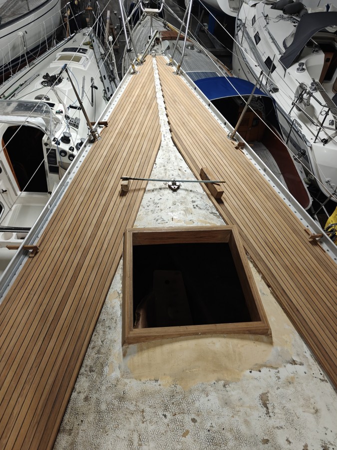

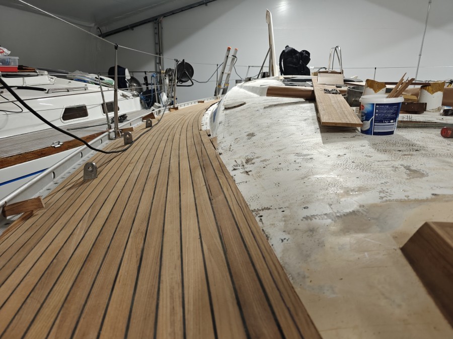

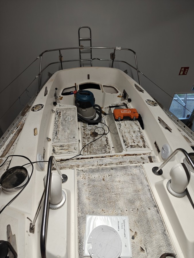

Pampero's refit is going on as planned and at the moment, new teak deck is being modeled at J.Petterssons boat yard near Hanko. I'm starting to understand why it's so expensive. The amount of time already used for just removing the old deck and sanding is remarkable. Must say that these people are real professionals!

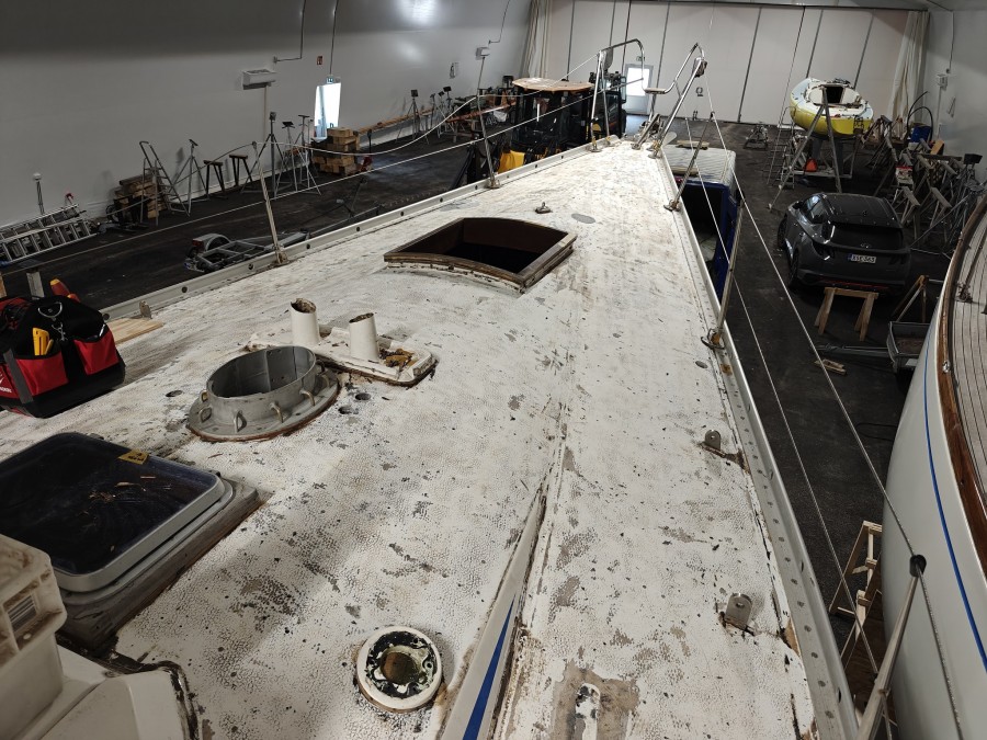

There are few pic of the project below, after removing of teak deck.
Funny detail is that there was "funnyface" drawn at the Nautor factory back in 1976 when Pampero was assembled by someone.

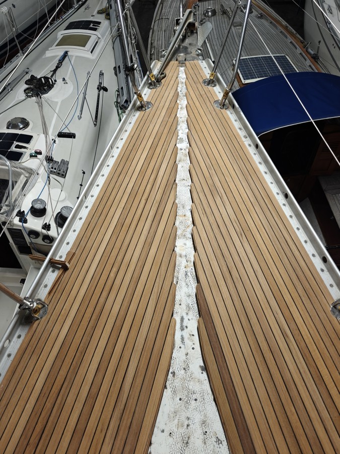

Pampero's project continues and here are three pics from this week. I'll post more of them as the deack is beginning to shape.

Thank's Matteo!
I will be keeping you up to date. I had a quite "tight" schedule for the past months so now it's loosing up and more time for writing.
Front hatch is Lewmar ocean 70 (694x694) flush mounted (item 39670070).
First arrived hatch had some manufacturing flaws so I made a reclamation. The second one is better, but unfortunately not as good quality as same ones back in 90's.
After a lot of searching through the internet it seems that most of the different brand manufacturers use same parts these days. So only difference is how the hatc looks like.
I'll PM you for the winches.
At the moment, ideas are welcome for constructing the anchor chain locker.
FAir winds to all,
//Henri
