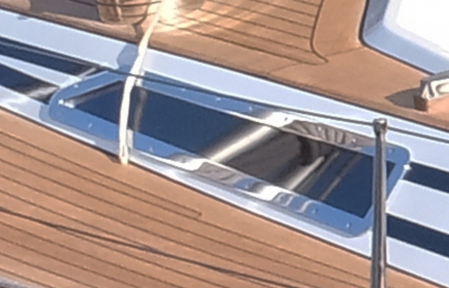

21 December 2024 - 19:31
Dear Don,
onboard Vanessa too the original damaged GRP frames have been rebuilt in stainless steel, and the old one have been used as a templates. It's an easy job for nearly any shipyard, as Stefan said.
New ones (see attached pic) have been installed with butylic, in 2016, not a single drop of water came in so far.
Fair winds and happy Xmas!
