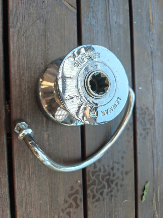

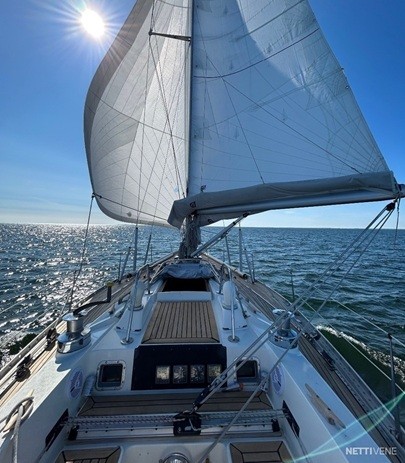

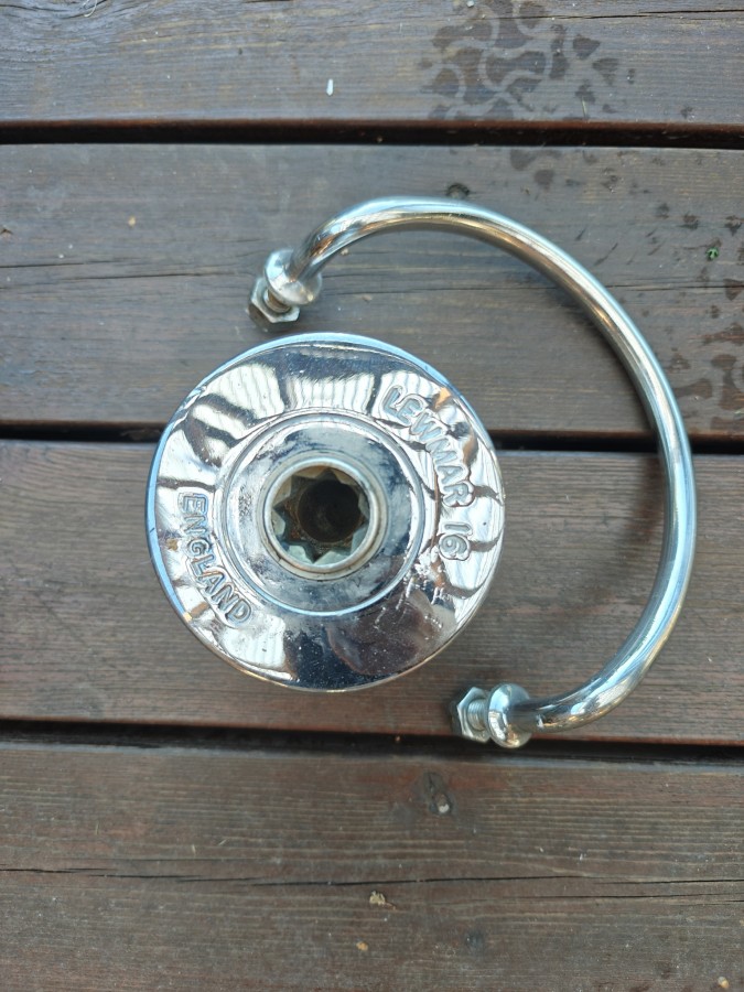

here are few pics of the original arrangement. I also attached pictures of the original mainsheet winch. You can see the guiding rail where rope goes through before winch. Purpose of the rail is to maintain the angle of rope as good as possible when sheeting.
Hope this helps.
//Henri
s/y Pampero (41/048)
Original mainsheet arrangement
Original Lewmar 16 winch main sheet
