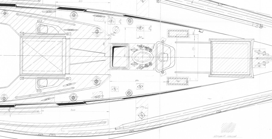

Hi Robert,
for the 411 I have a deck lamination plan. It shows where the laminate is solid vs sandwich. I would assume a similar document exists for the 41. I do not see the thickness on the plan.
Below is an excerpt from the 411 plan.
Christian 411/028 IF

Thanks for the roof plan. The idea to check the screw for electrical roof lamp is great. My guess if that the foam is minimum 15 mm, probably 20 mm plus the glassfiber thickness of the inner laminate of 2 mm. I just a feww mm to get a solid grip in the inner laminate.
