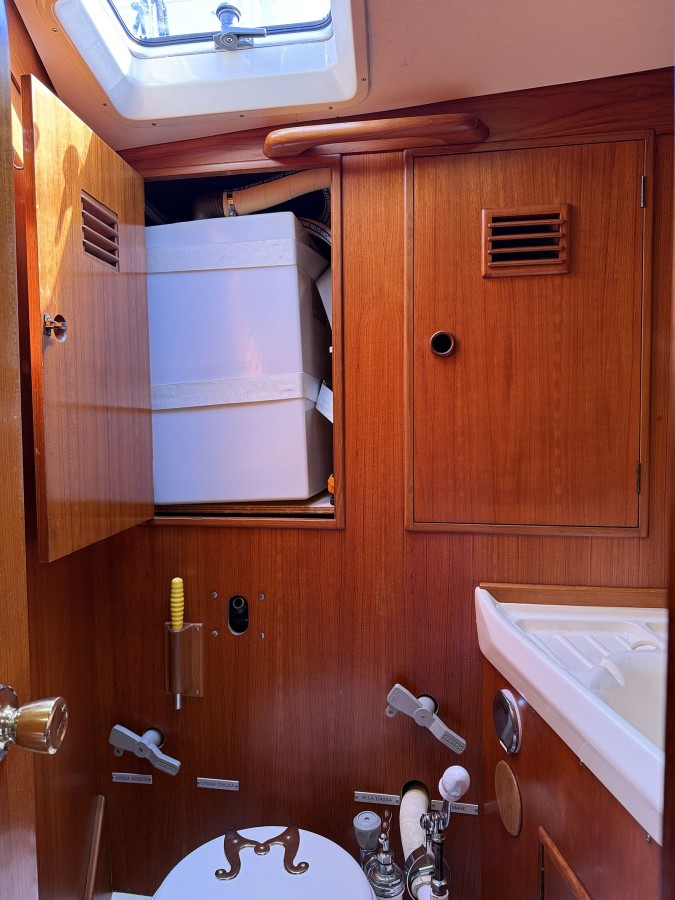

24 April 2025 - 11:50
I found a better image, here you are!

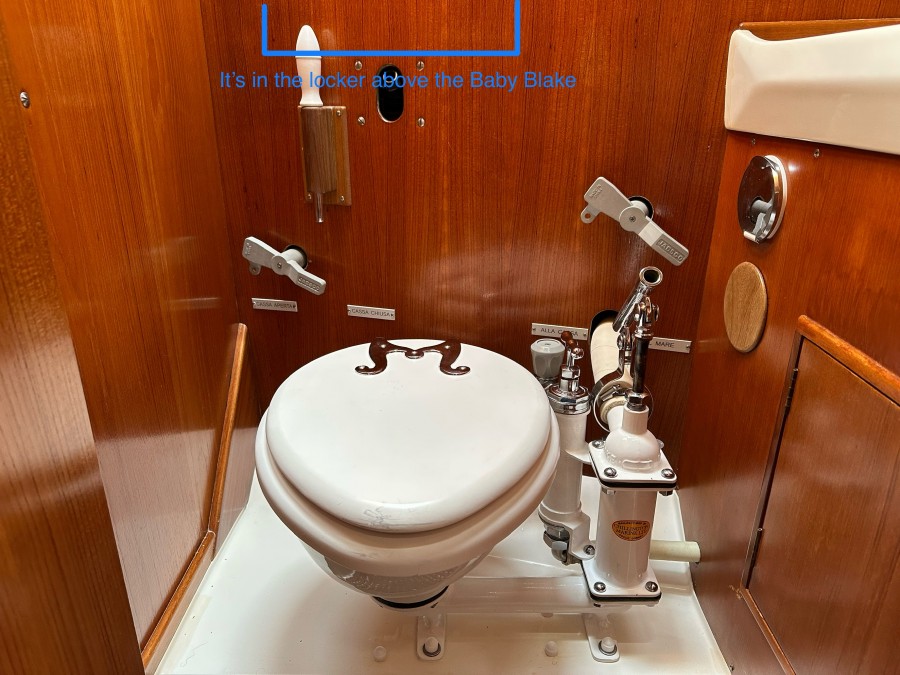

24 April 2025 - 16:22
Our solution is described here: https://www.classicswan.org/forum/post_thread.php?thread=2228&nopage=1 . So far no issues with odor. I agree a gravity-based tank setup in the head itself is the best possible solution, but in a 411 space is very limited there.
