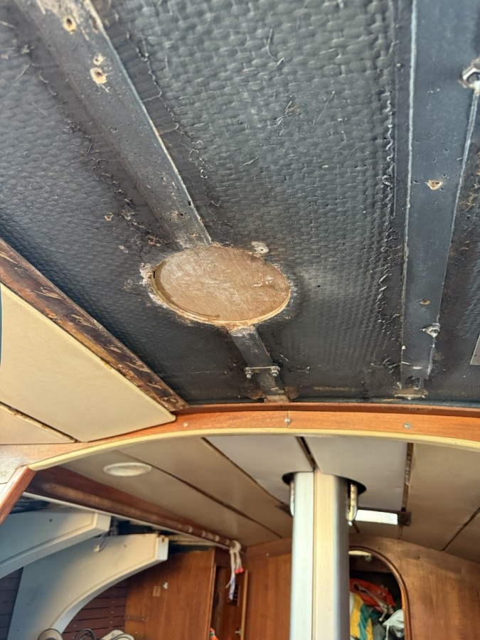

Evidence of old hole in the deck
Hi, just wondering what used to be here. Was there originally a small round window on a Swan 44?

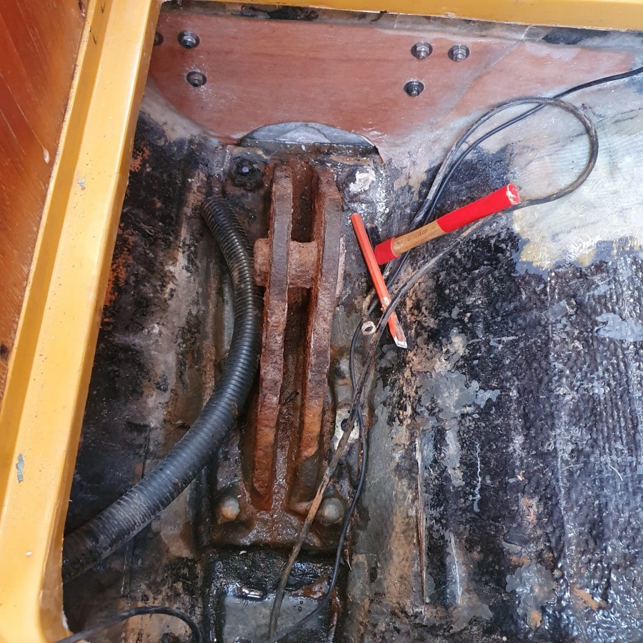

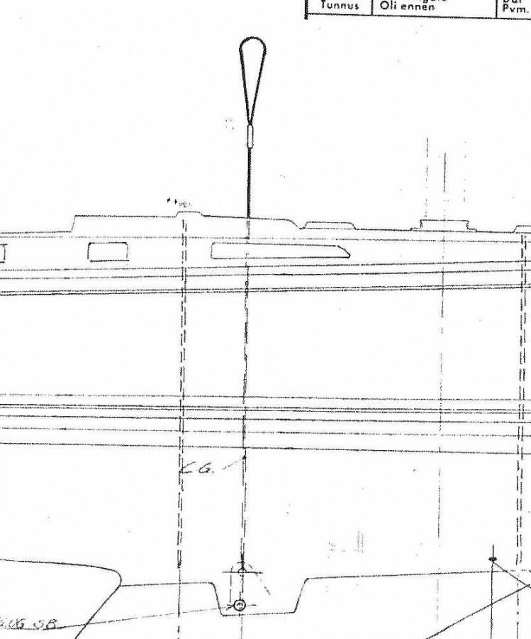

Dear Sweyn,
to get the cable to the single lifting point (see attached, in your bilge), peculiar to every S&S designed boat.

Ahhh!
That makes sense!
Thanks again Matteo, it did seem strangely small to be a hatch.
