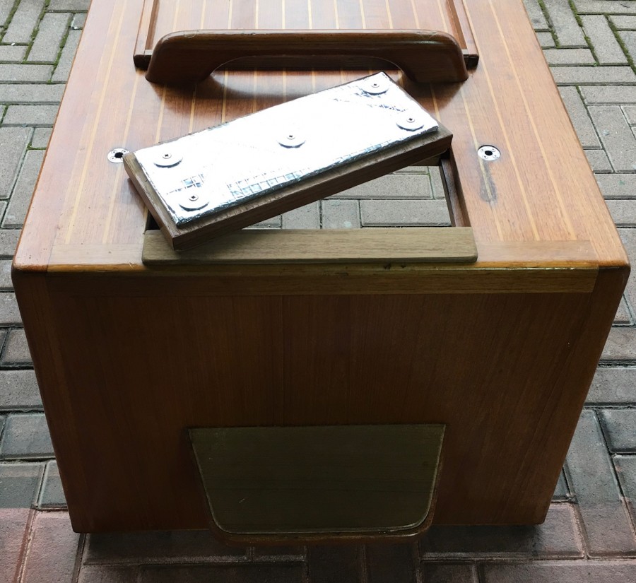

unless Nautor is still able to sell you the original hinges (worth a message) you should rebuild them. Not a difficult task for a stainless steel shop.

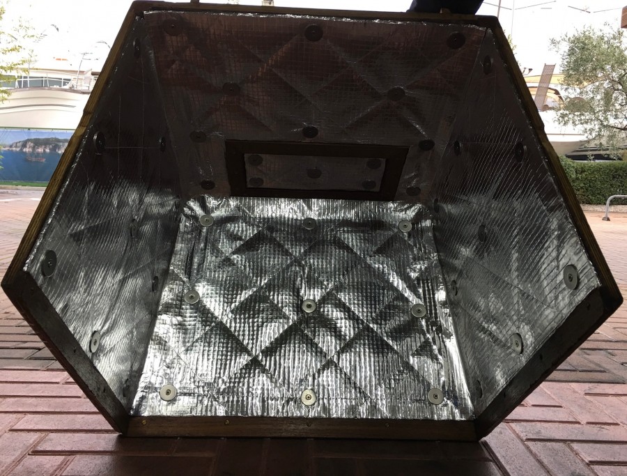

It would be a wise idea to modify the engine cover as it is per origin in the S&S Swan 38, with a small porthole on top of the box, so you are able to inspect the engine bilge anytime without opening the heavy cover, please see attached photos of the modification I din on my 47 (which did not have the inspection port per origin).

Thanks Matteo, that's a good idea re the inspection hatch.👍
