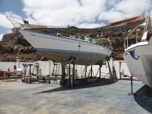

Swan 411/022 restoration

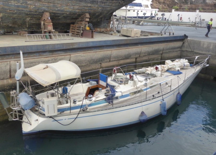

Major restoration work has started on the 1978 Swan 411/022 at Puerto Calero service centre in Lanzarote.
The work involves repairs to the hull, keel, rudder & mast together with replacement of the standing & running rigging, holding tank and other minor items as they crop up.
The work is being well supervised by the surveyor who conducted the original survey in February 2025.
Puerto Calero is a Nautor Swan approved service centre.
The work is expected to take around 90 days. The boat should be back in the water by November 2025, but don't quote me!
In summary, the project will not be inexpensive but should result in a 411 in good condition.
I'll aim to provide updates and photos as work progresses. I'm happy to share details with those interested or who may be carrying out similar work.

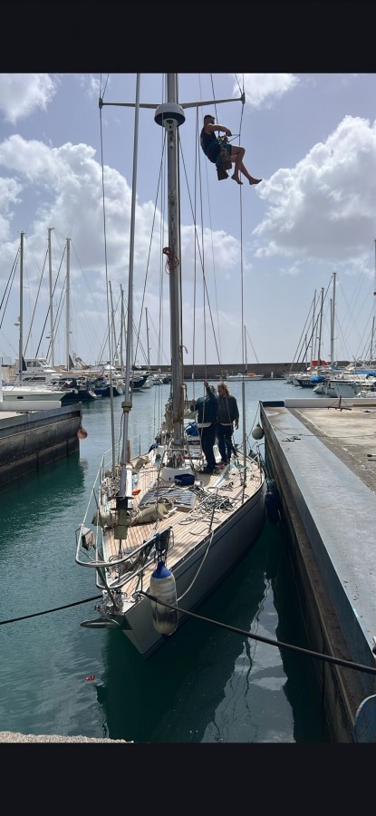

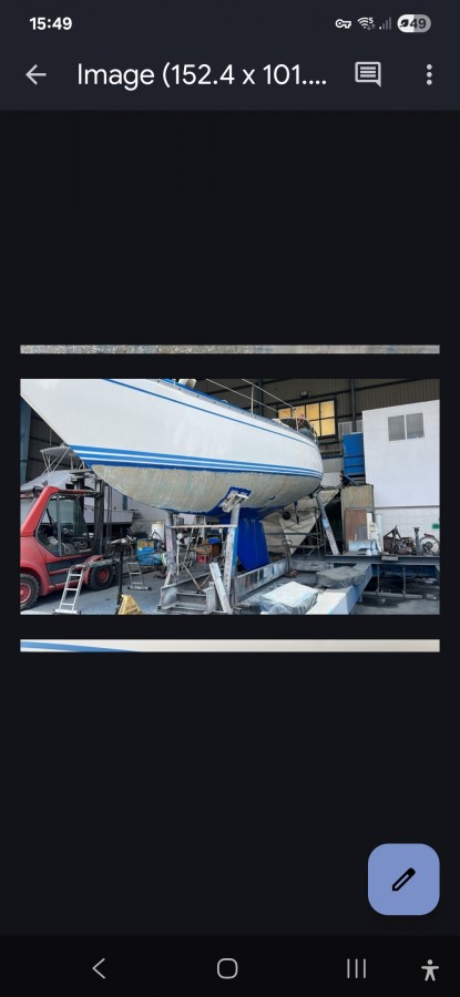

ready to be hauled

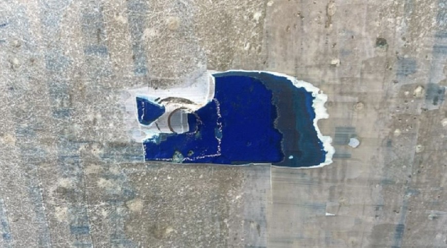

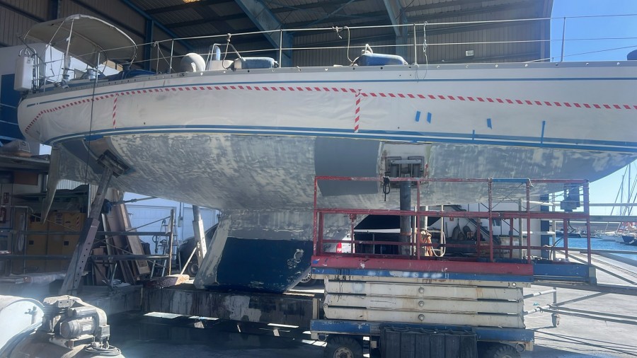

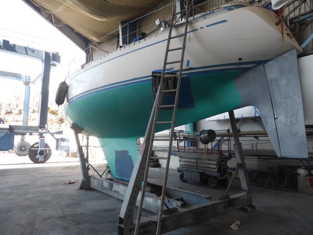

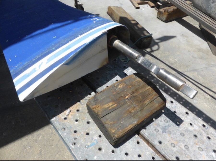

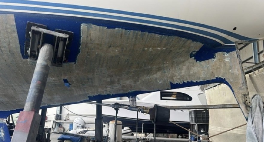

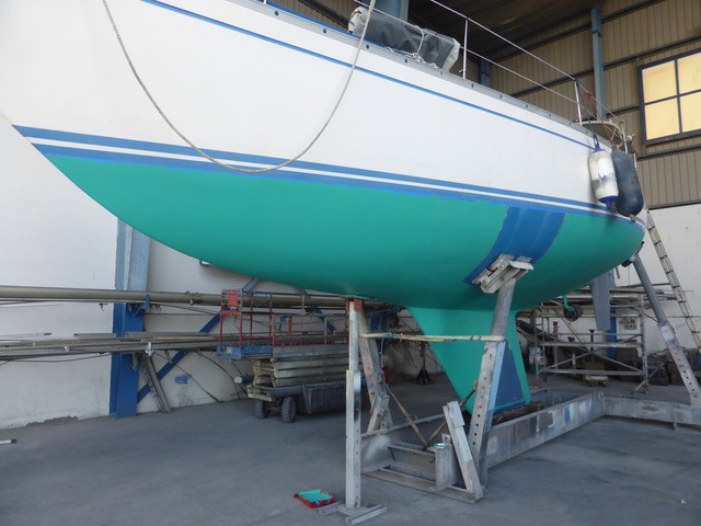

Swan 411/022 is under cover. Peeling work on the first layer port side is finished. The surveyor expects two more layers to be completed by next week as extra manpower and two peeling machines will be used
One machine was damaged when the machine hit an old bronze valve that had been marked. The machine required repairing with a new blade and bearings causing a delay!
Work on the rudder is progressing well with new tangs to be fitted next week.
Once peeling is completed the keel will be dropped and checked. A keel condition report is expected by mid August or thereabouts.
Here are a few photos of the hull peeling and rudder work in progress.

Two layers of hull peeling has reduced the moisture content to under 30 in most areas. The surveyor advises a further peel may be necessary followed by hot vacuum pads to further reduce the moisture content.

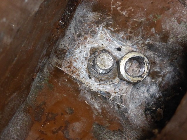

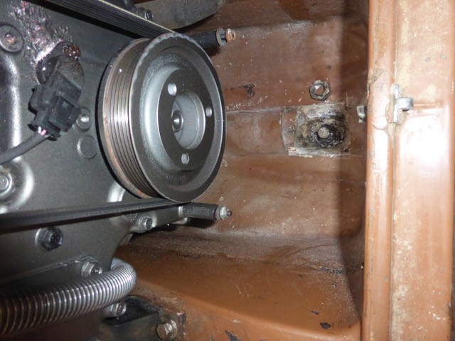

Keel removal in underway. See photo showing the aft most keel bolt that requires the engine to be lifted for access.
Aft keel bolt
23 August 2025 - 10:02
Dear Michael,
1 - thanks for the update, very interesting, could you please send more and detailed pic of the keel/keel removal when you have them?
2 - good the drain plug has been preserved (you can't imagine how many owners have sealed it!)

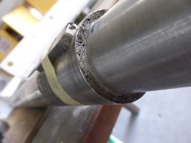

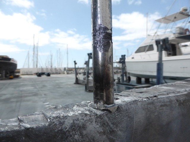

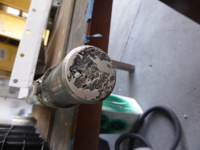

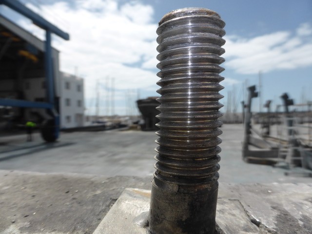

Work progresses on the keel and rudder. Note that the aft most keel bolt & nut have been accessed without removing or lifting the engine because of the shorter length of the Yanmar 4JH45CR compared to the Perkins 4.108 (see photo).
The keel bolts and nuts appear to be in reasonable condition after 47 years!
The rudder shaft has corrosion in some areas. The workshop is machining off the  corroded material. If the corroded areas cannot be removed within tolerances a new shaft will be manufactured. It is hoped this can be avoided!

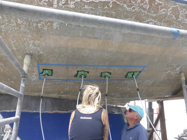

Work on hull peeling has reduced moisture content to 20 or less. The hull drying process with vacuum heat pads will start shortly.
Relaminating will get underway once the hull has dried out further and the keel has been refitted.

Keel bolt & nut appear in reasonable condition
Aft most bolt accessible by removing engine cover
Rudder shaft corrosion

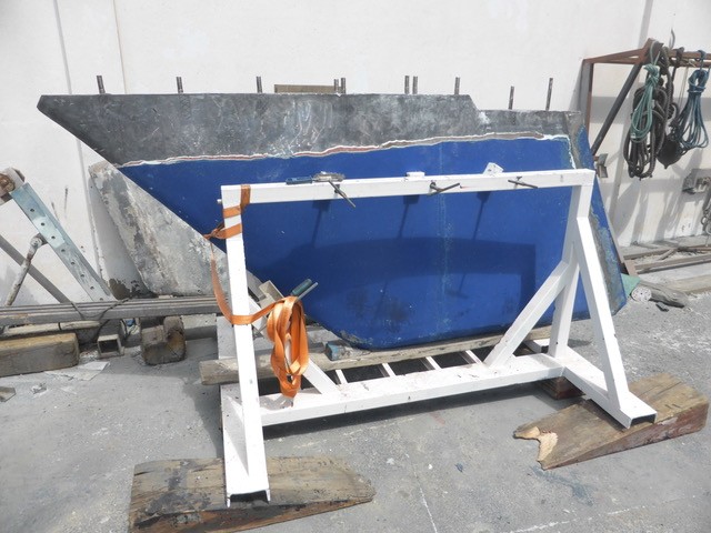

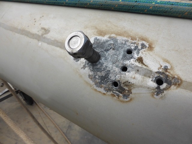

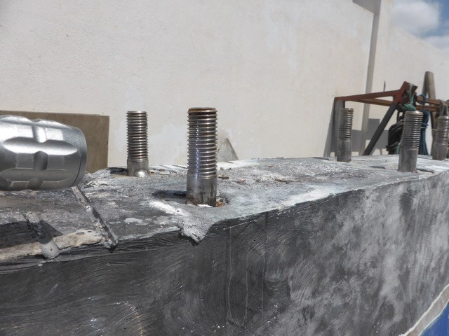

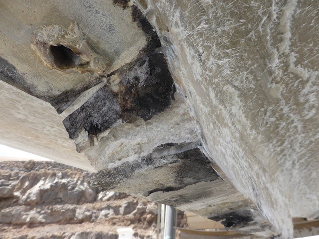

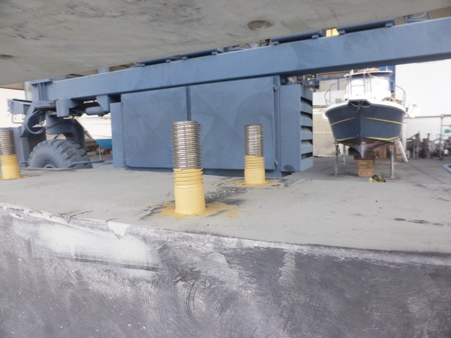

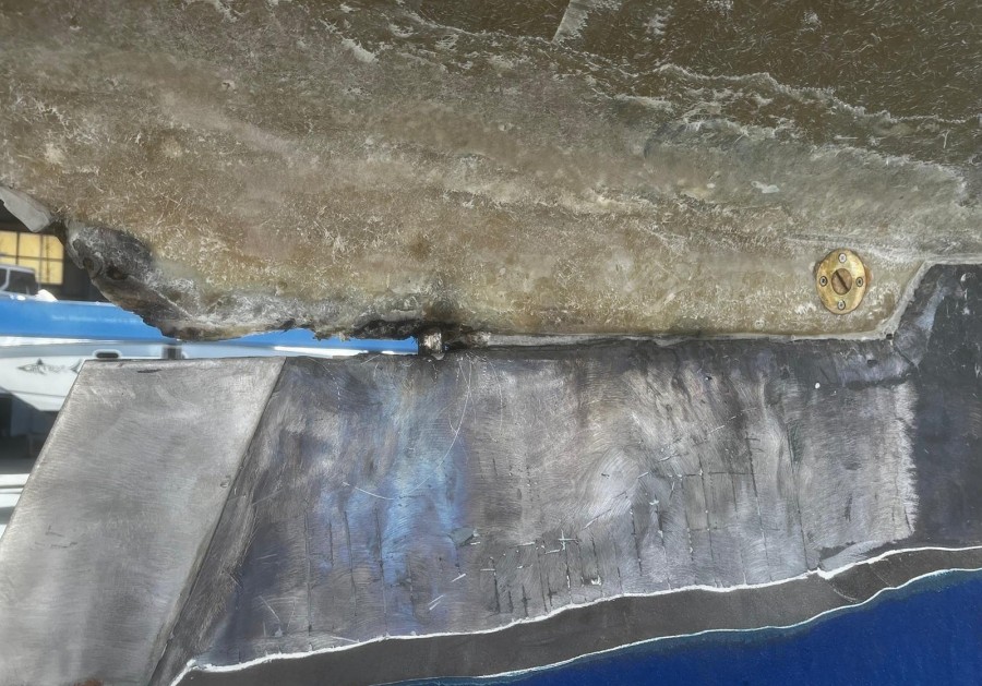

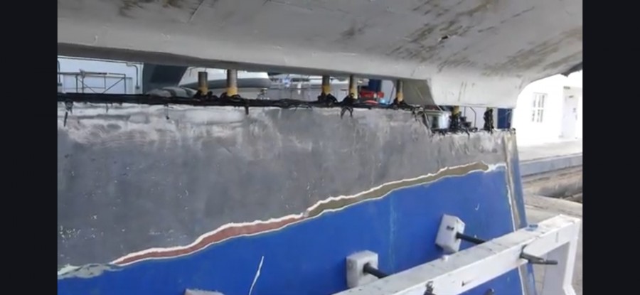

The keel has finally been persuaded to part ways with the hull (see photos) after much wrestling with removal of epoxy adhesive that had been used as the bonding adhesive. The surveyor and yard are recommending the use of 3M4200 sealant for refitting the keel to allow for flexing while retaining a waterproof joint and for ease of future removal if necessary.
The keel bolts are mostly in reasonable condition (see photos) with the exception of the aft most, longer M20 bolt, that is slightly corroded and will need repair work (see photo).
The rudder stock corrosion (see photo) has been machined off and the stock declared suitable for refitting.
The hull stringers have been checked for delamination (see photo) and found to be in good shape with no signs of delamination of the foam core.
The hull to keel joint will be cleaned up, coated and smoothed with epoxy in preparation for refitting. Any damage to the lead keel itself will be repaired.

Michael Dalton - (411/022 - Sundance)
Keel reluctantly parted from hull
Keel bolt in reasonable condtion
Only the aft most keel bolt has some corrosion

Additonal photos related to my previous post
Hull to keel joint to be cleaned up and epoxied
Area of slight keel damage
Rebuilding will start soon!

Michael Dalton (411/022 - Sundance)
No stringer delamination noted
Corrosion machined off and declared good to go

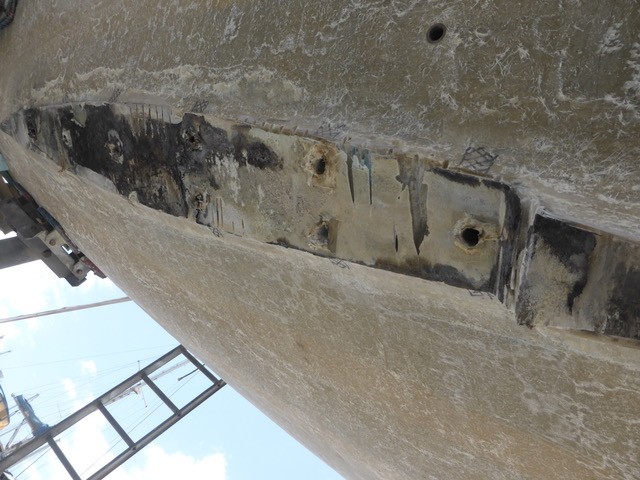

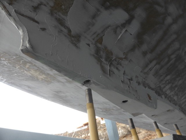

The mating surfaces of the keel and hull have been rebuilt to a flat and strong profile using epoxy resin. The keel bolts were cleaned and coated with Awlgrip 545 epoxy primer. The keel has been refitted using 3M4200 to provide a waterproof yet flexible joint.
See the attached photos of the keel bolts, hull and keel.

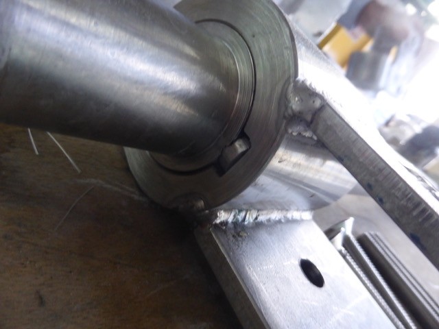

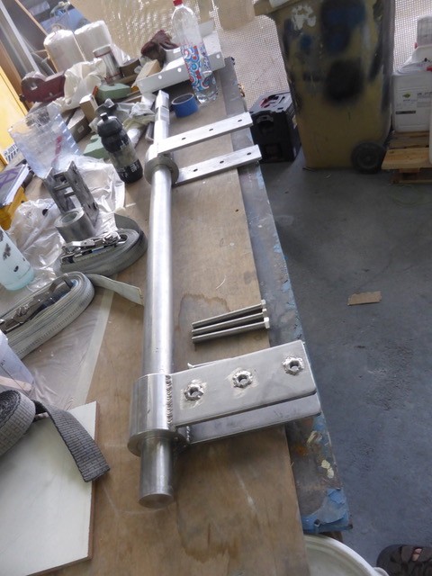

The rudder stock has been carefully machined to remove corrosion. The tangs were cleaned and polished. The whole assembly has been rebuilt and fitted with Delrin bushes.

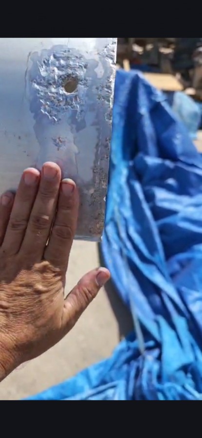

Mast corrosion at the cap shrouds has been removed and cleaned up prior to fitting new stainless steel shroud plates.
See the attached photos of the rudder stock and the mast cap shroud attachment area.
Next steps are relaminating the hull with epoxy resin and glass fibre matting to build up the 3 layers of old polyester resin and fibres that were peeled off the hull below the water line to remove osmosis.
After 6 weeks dismantling the mast, keel, hull and rudder it's a great relief to see the boat being put back together!
Overall, the yard at Puerto Calero in Lanzarote is doing a great job in conjunction with my surveyor Andrew Edmond from Compass Marine Surveys in the UK.
Michael Dalton - 411/022 (Sundance)
Hull surface prepared
Keel bolts prepared with Awlgrip 545 epoxy primer
Lowering the hull onto the keel

Additonal photos of work to the rudder and mast.
Cap shroud attachment corrosion
Rudder stock refurbished
Rudder stock

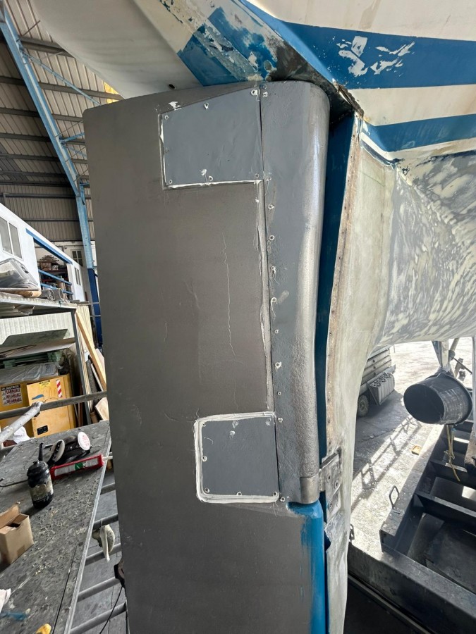

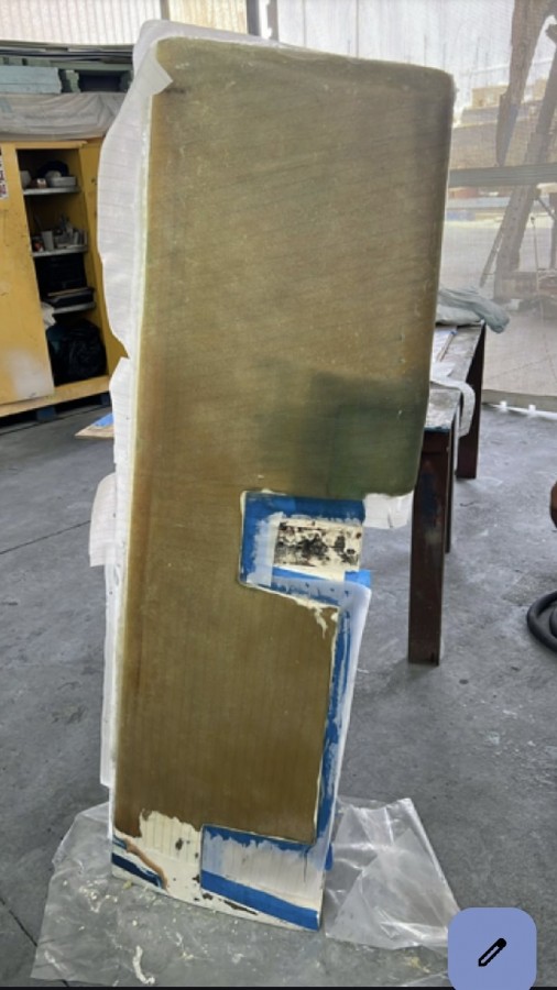

The rudder has been finished, reinforced and attached back on the skeg.
See the attached photos.
It's understood that some later model Swan 411 boats have had the rudder extended below the bottom of the skeg. The modification, approved by S&S, was designed to provide additional control particularly downwind.
It would be interesting to hear comments and advice from any Swan 411 owner with the extended rudder design.
The rudder on Sundance 411/022 is as built. The rudder extends only to the lower end of the skeg.
The unstepped mast has been examined carefully. Several areas of corrosion were found at the stay attachment points, on one of the spreaders and heavy corrosion on the keel stub and shoe.
The section of the mast inside the yacht from the deck to the keel stub will be painted with white epoxy paint.
See the attached photo of the damaged mast stub area.
The mast repairs are being carried out by aluminium welding and careful sanding. Photos of the repaired mast areas will follow.

Additional rudder and mast photos of Sundance.
Michael Dalton
411/022 (Sundance)
Corrosion on mast stub
Rudder refitted
