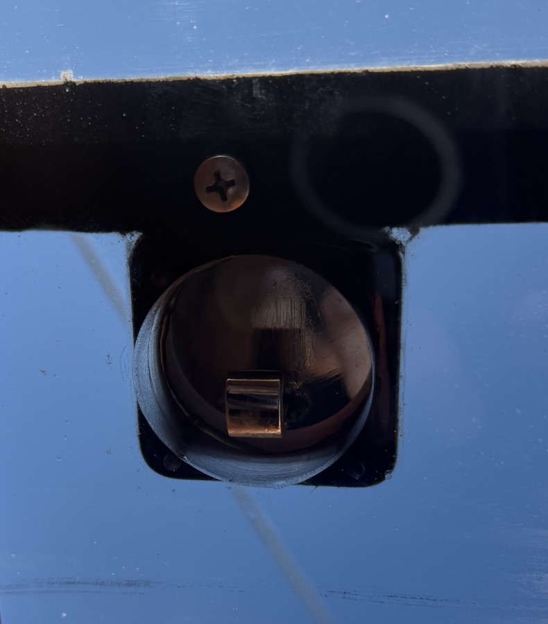

The foredeck hatch on my 41, Cavallino, has the original looks but must have been rebuilt / modified at some point. It is missing latches, and I was hoping someone could help tell me what these latches were and if they still can be sourced?

Dear Andreas,
I think you can find similar locks on the German shop toplicht.
Attached is a pic of the original one.
matteo (47/969 Vanessa)

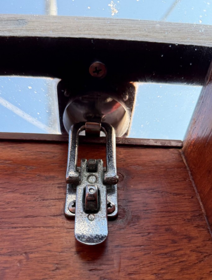

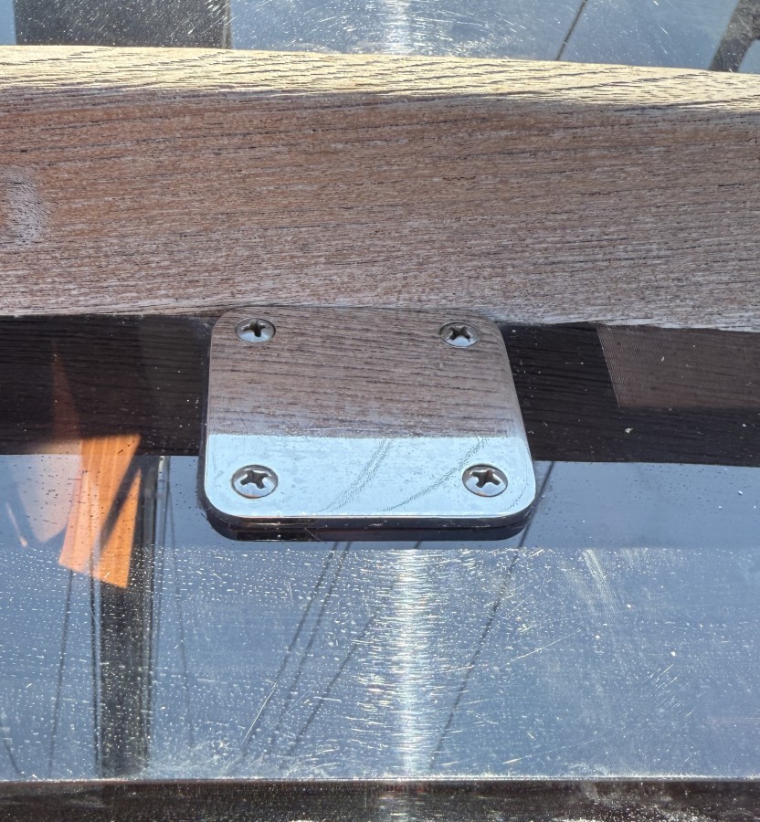

12 August 2025 - 16:11
Dear Andreas,
correct, Nautor custom built (please see attachments).
Stainless steel plate from outside

14 August 2025 - 05:47
Hi Andreas,
we have the same fixtures on the hatch as can be seen on the photos of Matteo. I believe they are simple to reproduce. Since the hatch is sliding, it is not possible to have a hook extending beyond the lower surface of it.

14 August 2025 - 08:58
Join Date: 19 May 2019
Posts: 13
Thankls again, these pics are just waht I was looking for 😊.

14 August 2025 - 09:01
Posts: 13
Thanks Christian,
Spot on – this is just my reflection. Now I just need to figure out how to lay my hande on 4 of those 😉

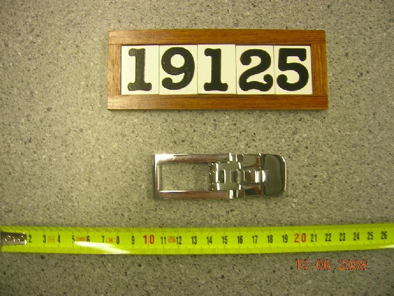

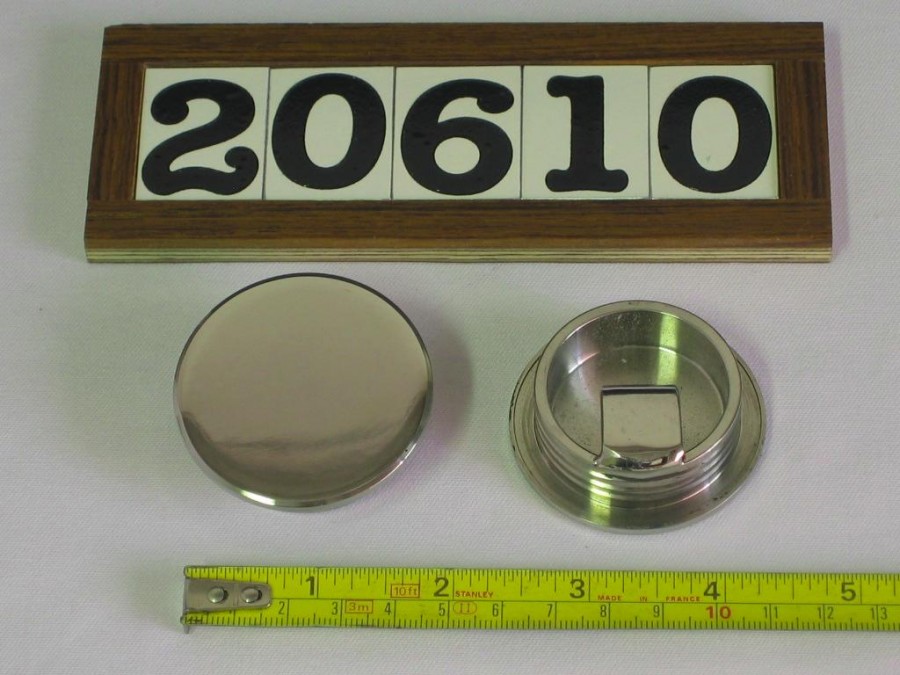

18 September 2025 - 22:02
For your information I am attaching the pictures of the latches I bought directly from Nautors in 2009 following the advice of Lars Strom.
Unfortunately I ordered only two of them and I regretted it for years; four is the ideal quantity. While the latch is probably easy to find, the "imbedded hook" part should be custom built.
Daniel, Luna Menguante, 411/004
Part that goes into the sliding cover

07 October 2025 - 11:24
Posts: 13
Hi Daniel,
Sorry about the late reply and thank you so much for the photos, they are great and gives me full appreciation of what they look like. I wish I could get hold of 4 somewhere but may have to look in to having some made.
Best
