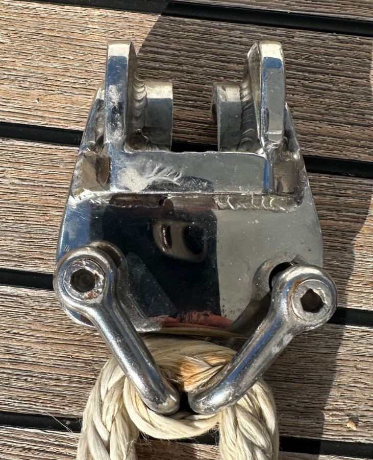

on 411/009 Oracabessa there was a CQR (sorry, do not remember the size) with a 8  mm. chain, and they had a lot of holding problem, which ended when they switched to a 10 mm chain.
I remember perfectly well because Stefano (at the time owner of Oracabessa) gifted me the fantastic anchor hook made by Nautor (see attached pic) which did not fit anymore with his new 10 mm chain (I have now modified it to get it to the 10 mm chain I have on Vanessa).
