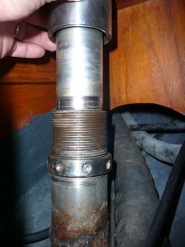

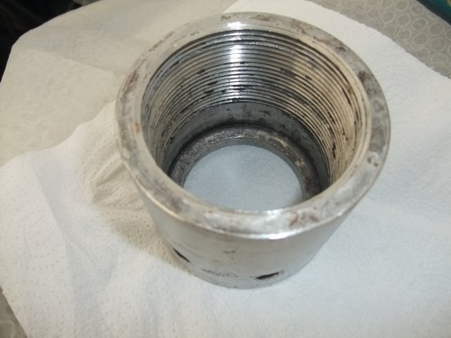

Dear Bjorn,

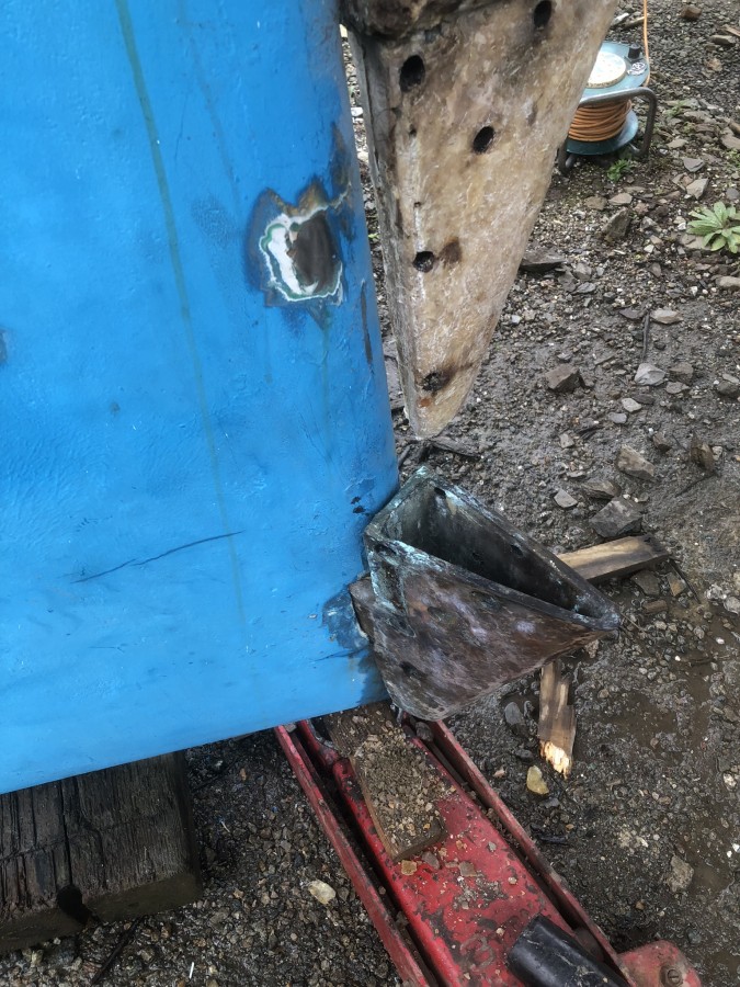

just sent you a PM with detailed description on how the job should be done, in the meantime, as requested, please see (this post and followings) a series of images (sent you higher def images by mail too)
Please keep us posted on the rudder refitting proceedings, thanks!
All best,
Bottom bronze shoe
Gland and lower ring
Bottom bronze shoe dismantled

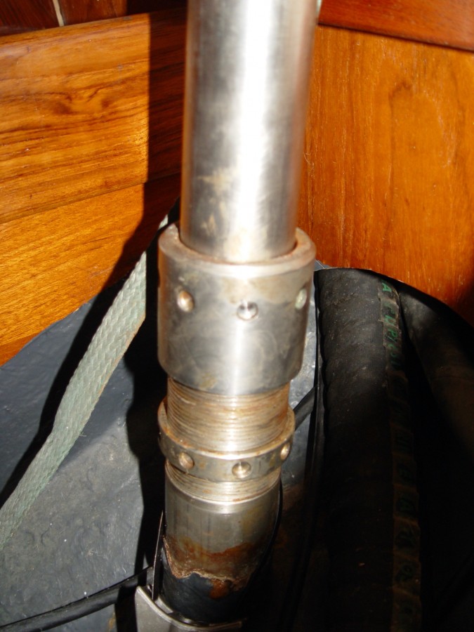

08 November 2025 - 16:50
Posts: 1149
Gland
Gland, shaft where seal should be positioned, and bottom ring
Correct positioning of the seal

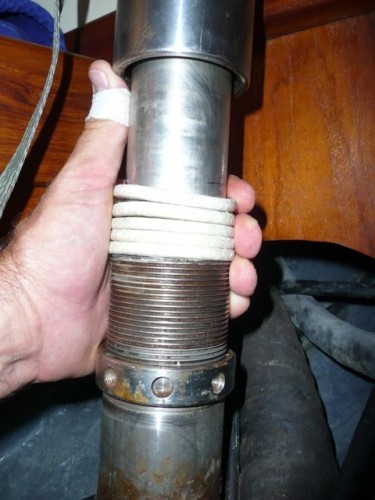

08 November 2025 - 16:51
Posts: 1149

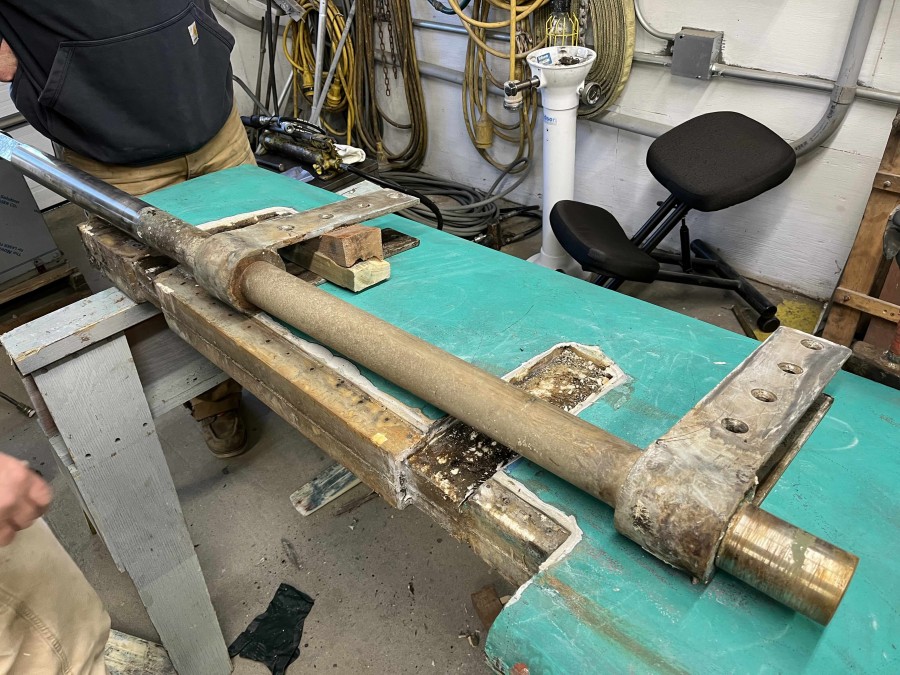

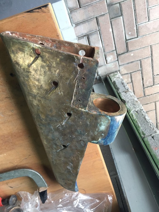

Hi Bjorn,

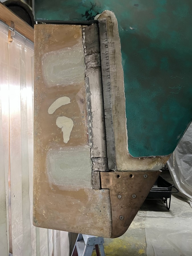

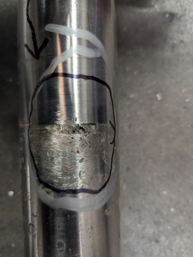

Here are some more photos of removal and rebuild of the rudder on our 1972 Swan 48, Galatea. Like Matteo, I also sent a link to your gmail with more photos and movies that show how the rudder was dismantled and rebuilt. I hope these are useful and not too late. Best of luck!
Sincerely,
Robert (48/013 Galatea)
rudder post removed
corrosion on rudder post (which was later repaired)
rebuilt rudder installed, skeg repaired (before fiberglass)
