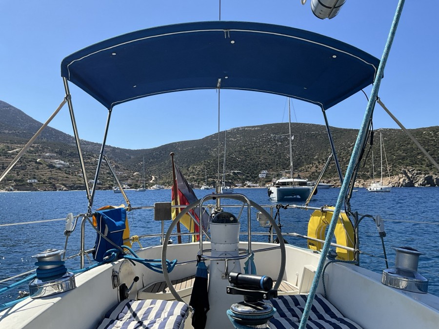

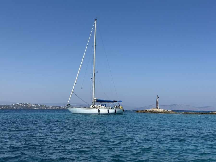

we have a 200 Wp flexible panel on top of a bimini, plus a 50A B2B charger. Being in Greece, there is plenty of sun, and we never need to run the engine just to load the batteries (300 AH AGM 12V).

Hi Christian
Thank you for your advice and photo
Your combined bimini and solar frame looks good and does not obviously detract from the classic lines of a Swan 411.
My surveyor has suggested 2 x 410 watt REC Alpha solar panels. These would be a tight fit on Sundance but very effective in charging the 3 x 200 ah lithium ion batteries.
I'll see how we can install something similar to your arrangement.
