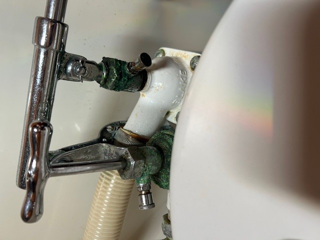

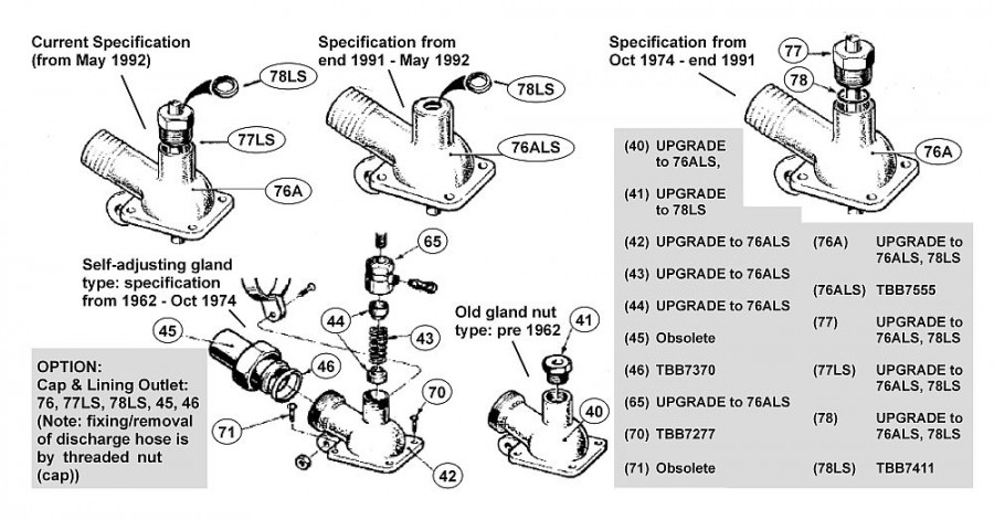

I am taking my discharge & flush pumps apart to clean, paint & replace the seals. On my discharge pump I have the old 1962 to 1974 top nut version with a self adjusting gland. Diagram and photos attached. Does anyone here have experience of that? What kind of maintenance / adjustments does it require? Should I "upgrade" it with the newer style nuts with the O-rings?
This is relatively new to me.....from a season of sailing & racing I have not noticed any specific problems....

Dear Hattie,
I am not sure you can upgrade it (I have the very same model and works very well even after 40+  years), anyway to be 100% sure  you ask them  (jackiecrosby@sea-sure.co.uk) .

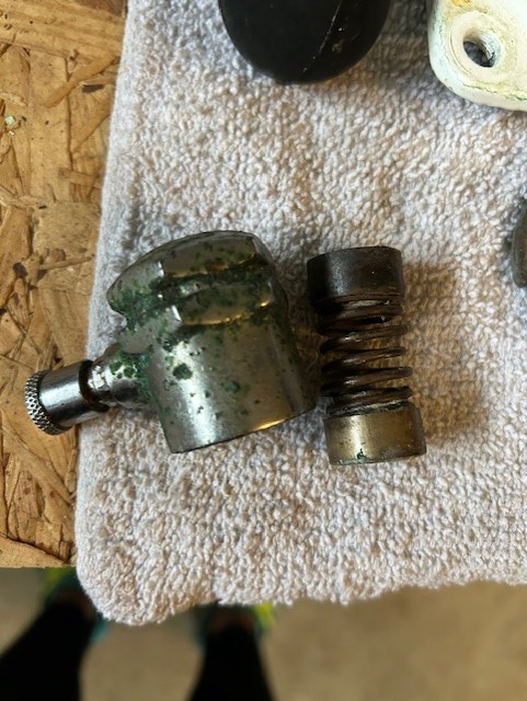

The model I currently have (and you also it seems) has a crew on cap, which when removed looks like its filled with grease....is that correct?
I would guess it acts the same way as the o-ring in that the grease seals any gaps.....and as you screw down on the cap it pushes more grease into the shaft - am I correct?
The grease was pale green so it looks like Blakes Seacock Grease.
05 March 2026 - 14:58
Dear Hattie,
all correct (and in my opinion it works better than the later model, which you have to dismantle when the o-ring is worn out).

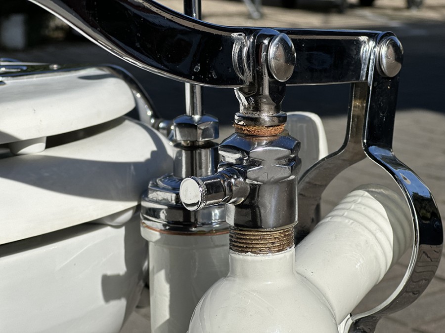

Attached is mine.
