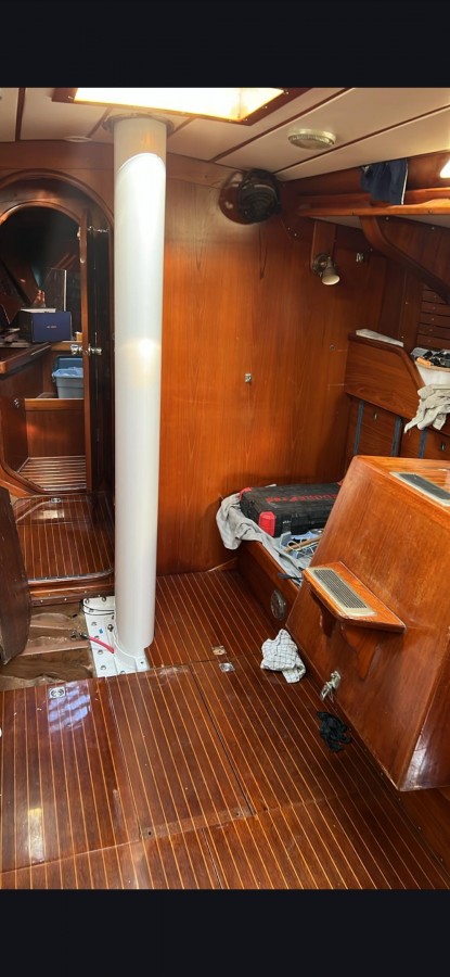

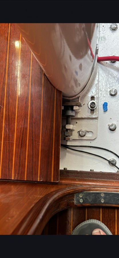

Swan 411/022 mast step & base restoration
Repair to corroded mast base

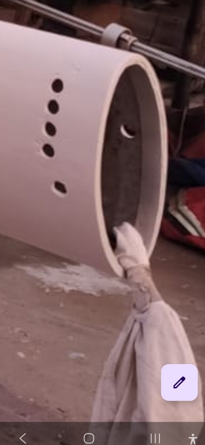

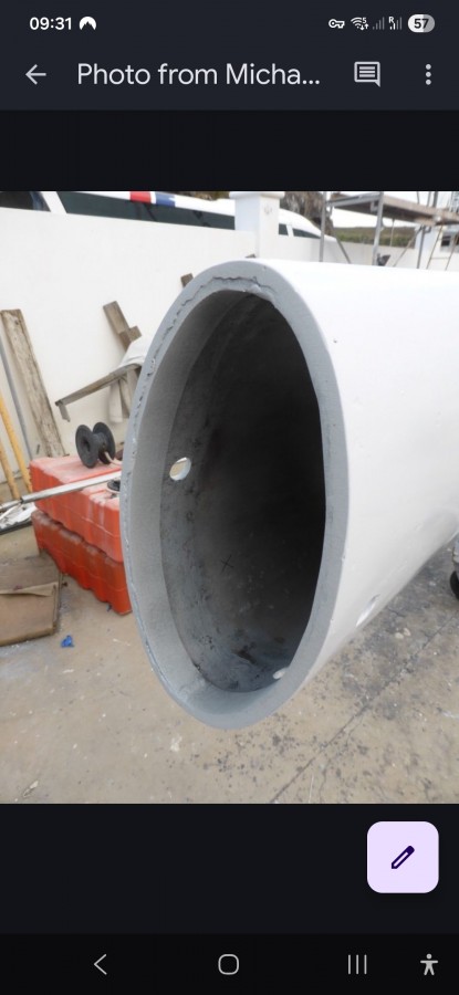

Derusted and epoxied mast step
Ready for Spartite
15 March 2026 - 10:09
Join Date: 13 June 2025
Posts: 30
A short explanation had somehow mysteriously disappeared to accompany the photos.
The team at Puerto Calero did a great job in welding and smoothing the corroded Aluminium mast base followed by white epoxy on the lower mast section in the cabin.
The steel mast step was derusted and finished with white epoxy.

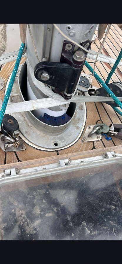

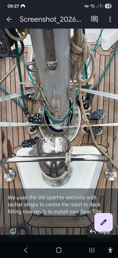

The mast was centered at the partners with a combination of ropes and webbing in preparation for Spartite. Incidentally the original can of Spartite had become hard and unusable. Allspars shipped out a fresh can via DHL from the UK.

A few more photos that may be helpful.
Mast base wide shot
Mast partners centering
Mast base close up
16 March 2026 - 07:58
Dear Michael,

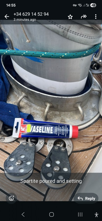

Very interesting thank you very much, do not forget Spartite Is not watertight so you need to seal the mast collar (e.g. with self amalgamating tape) to prevent water coming in.

Hello Matteo
Thank you for the heads up on the Spartite not being waterproof.
I'll make sure the team at Puerto Calero apply the necessary self amalgamating tape at the mast partners.
We're waiting for the replacement can of Spartite to arrive. With luck in the next couple of days.

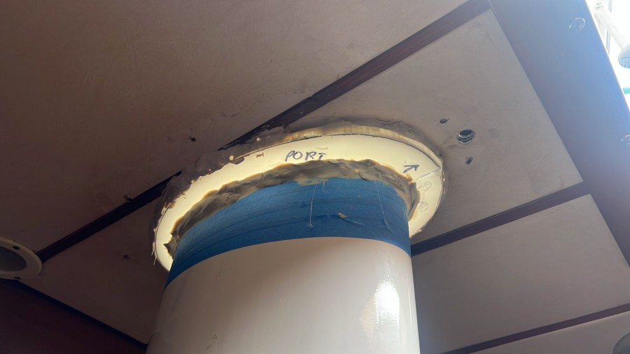

Spartite poured and setting, at last, at the mast partners. Vaseline was applied on the mast in the area to be covered with Spartite that will allow easier mast removal at a future date. Photos below.
Michael Dalton
Swan 411/022 - Sundance
Mast in cabin prepared for pouring
Spartite poured
