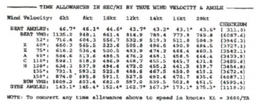

01 August 2008 - 19:12
Dear Yvon
Beg your pardon, I first succeeded in making a black page, and then the text comes after the table. Perhaps Matteo can clean it up?
Anyway:
Swan 41 was built with short and tall rigs, and there are also some intermediate lengths.
If you want to be precise the actual rig length would be needed as input.
IMS certificates contain the requested information in the form of time allowances, here the information for Swan 41 with tall rig I = 54.0'.
These numbers can be used for making a polar plot if required.

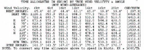

Dear Professor,
if you also have the polar speed table of 411, could you please post it. Does the draft (2.08, 2.22 or 2.4 m like mine) make remarkable difference?
BR, Ilkka
02 August 2008 - 17:40
Dear Ilkka
Here the requested VPP for the standard S411.
Your increased draught should improve performance slightly on the wind, suggest you check whether a difference can be detected.
