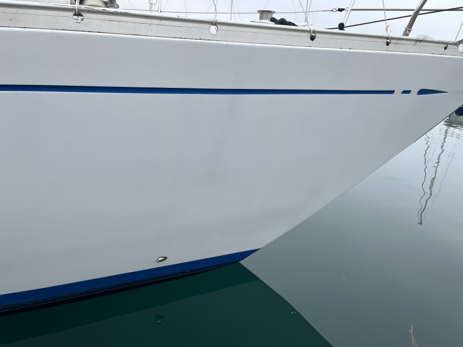

Hi, We have a Swan 48 (1972), and wanted to seek advice concerning the draining of the anchor well.
There are two drain holes at the end of the anchor well and these drain holes are just above the anchor well, they drain out the sea water from the anchor windlass.
I noticed there used to be a 80mm diameter hole that is now blocked off at the end of the anchor well bulkhead, there is also another hole that is in the end of the port bunk and can assume that this must have been for a pioe that took sea water from the anchor well and then water into the bilge?
When sailing sea water enters through the anchor windlass and assume a previous owner must have added the drain holes that are above the waterline and blocked off the pipe hole taking sea water into the bilge?
May I ask if other Swan owners of similar vintage have the same set up arrangement? and seek any advice on this matter?
Thanks

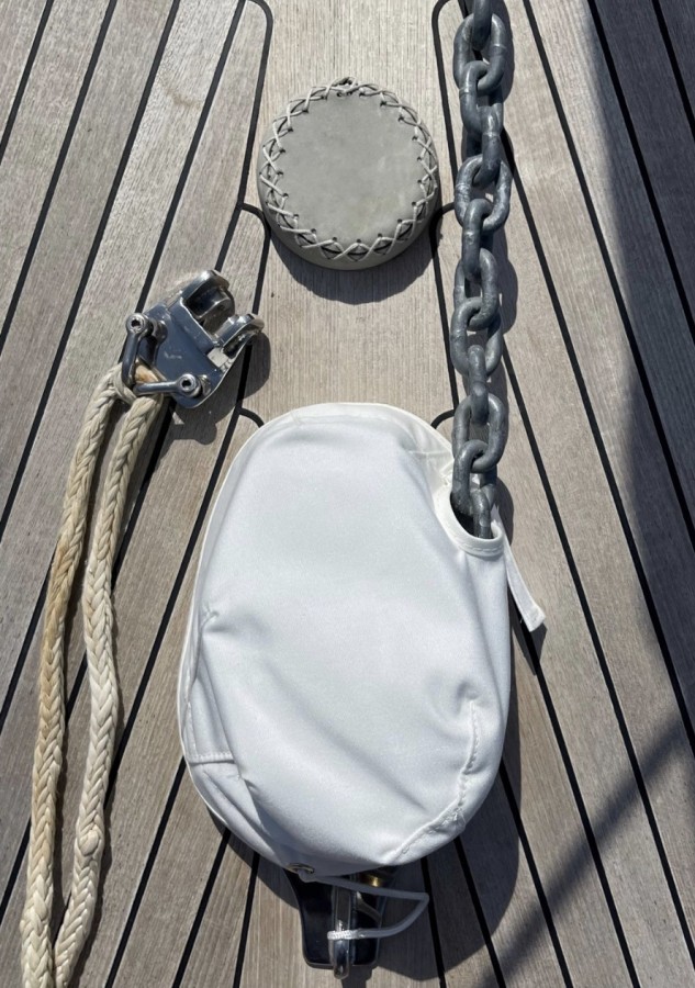

correct, not original.  " ...a cup of water poured in one of the far ends of the boat should be collected at the deepest point of the bilge...".  That's Rod Stephens mantra.
I would certainly onen again the filled drain on the bulkhead and a simple canvas cover on the windlass will prevent water to get into the anchor locker.  It worked 100% for me (see photo).

Matteo,
Do you find this solution safe upwind under heavy seas in the North Atlantic?
Brgds
Carsten
18 August 2026 - 07:38
Dear Carsten,
I think it's safer than having (not original) drain holes on the hull.
