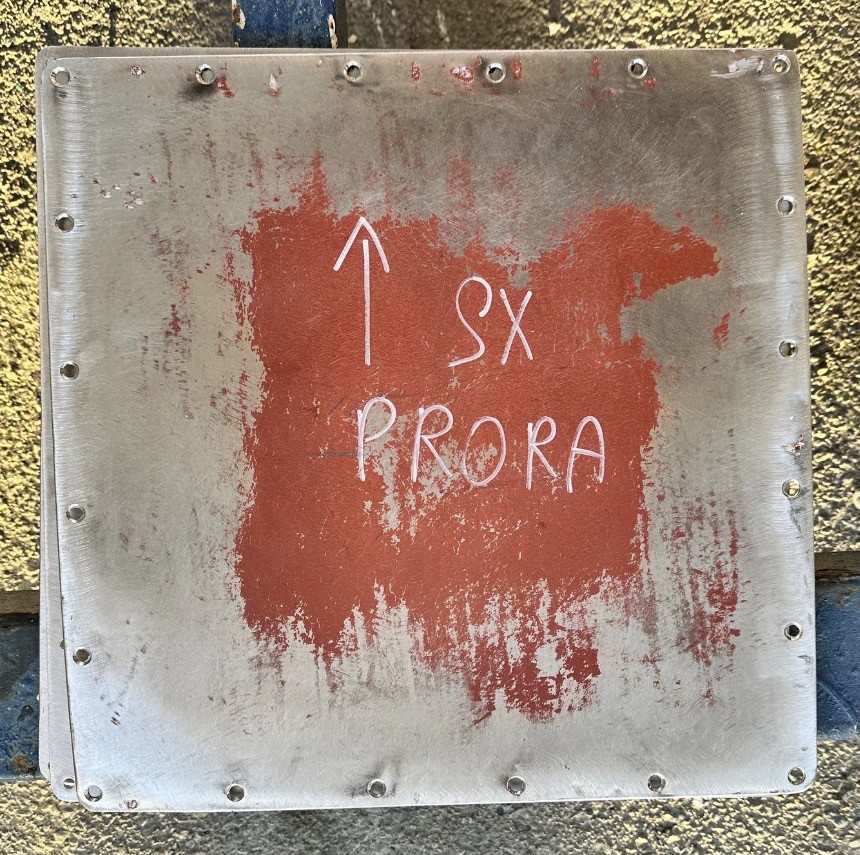

Dear Niels,
this is the original stainless steel steel plate to cover the pocket.

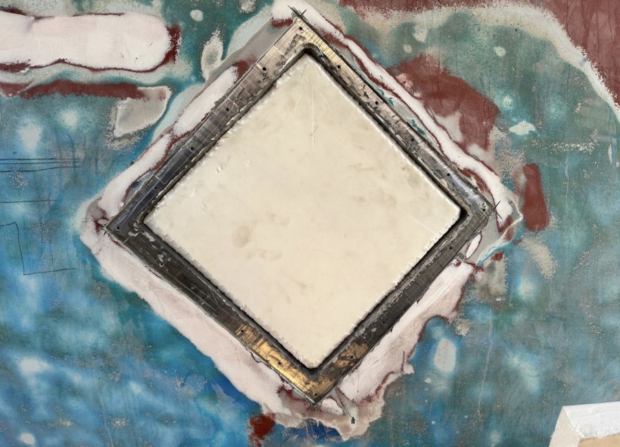

Filled pocket

Thank you so much for super quick reply.
The solution makes perfect sense.
