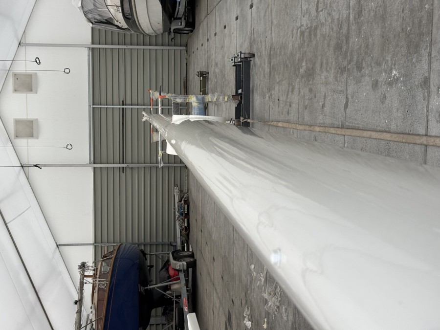

Hi everyone, I am in the middle of a refit of my 1971 Swan 55 Walross III.
One of the bigger jobs is a complete refurbishment of her mast. After drilling out all 1000 (!) rivets, we have removed the tracks of the mast in order to properly sandblast it and give the mast a fresh coat of awlgrip.
The alu mast tracks will be anodized again and then attached back on the mast.
I have had some conflicting advise on the type of rivet to use for this job (so alu track on alu mast).
I landed on stainless rivets, dipped in tefgel before inserting/clamping, but I have not bought them yet, so still a small window of time to get expert 2nd opinion from yourselves....
Any thoughts ?
