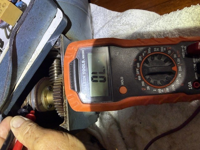

I’m looking for some help regarding replacing or repairing the NECO electromagnet coil clutch assembly.
After reaching out to Daniele from this forum, he helped me through a series of tests to determine the issue.  While having 12.64V on the brush assembly tips that contact the clutch slip rings, I still had no clutch engagement.  To test the electromagnet clutch an Ohms test was completed, which showed 0L or “infinite”, where it should have shown about 10 ohms.  I’m guessing a coil has burnt.
If someone has repaired the electromagnet coil clutch or knows of a shop that has repaired NECO’s and the clutch coils let me know.  Open to suggestions, both the original, NECO compass and NECO control unit work fine.
