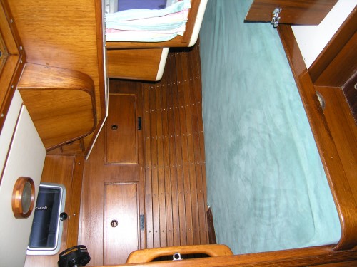

On the Mark 11 layout I'd say that the saloon is better than the 46 as its 9 feet long and the aft cabin less good than the usual centreline berth on the 46. Our aft berths, a double and a single were factory built 3 inches wider but the double is still narrow.
