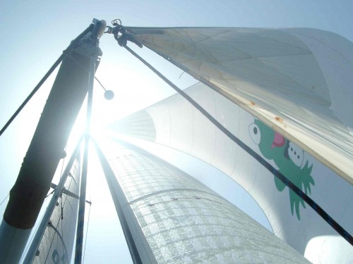

Dear Lars, Is a tallboy raised as a gennaker with head and tack, or like a genoa? we have an unusual sail on board that seems to fit your description, as it is really not a gennaker. it was used this summer as a third sail when our asymmetrical blew out, but out in front of the genoa and with a spi pole. hoping you can see the shape from the pics.
thanks in advance.
Jayne

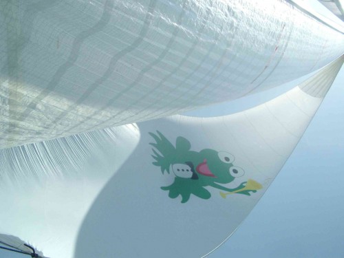

sorry, this picture didn't post the first time around, and it gives a better view of the shape.
J.
18 September 2008 - 20:57
Jayne
This looks more like a blooper. It is wider than a tall boy.
The tall boy was hoisted flying, i.e. without being attached to a stay.
You can find tall boy and blooper explained on the internet, or ask your sailmaker
