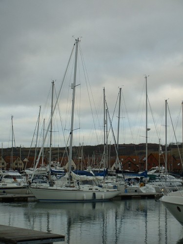

I am currently part way through the restoration of a tall rig Swan 40 called Can-can, and have just stepped a new double spreader Selden mast. The original mast had running backstays fitted to anchor points at the cross tree level. Does anybody know if running backstays were originally fitted and where were they secured to. I have looked at many photos and can't find any. We have tracks which run along the top of the toe rail next to the cockpit and think this is where they were secured, however there is also a ring / fairleed further aft and a fitting adjacent to the spinnaker winch on the side deck, however we think the later is a place to secure the spinaker guy. Any feed back on if our assumprions are correct and sailing with them would be most welcome.
