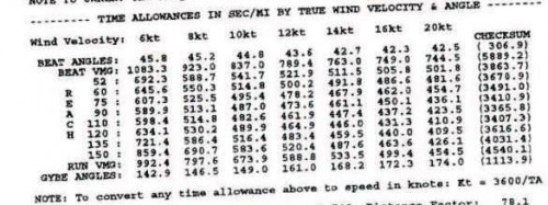

Dear Richard and Fernando
Here information from an old IMS certificate.
