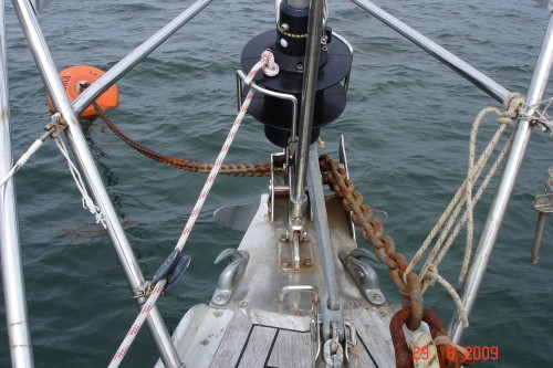

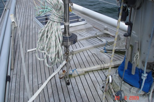

  Last winter I fitted a second roller furler to my Swan 41. When I bought the boat, there was provision for a moveable stay (8mm) which could be set up on the stem just behind the genoa furler using a backstay tensioner. There were no effective heavy weather sails supplied with the boat, only a stretched out old genoa which had obviously come from a smaller boat, and a storm jib. We did try the storm jib last summer in a gale, however its area was really too small for force 7 to 8. The moveable stay was parked on a deck fitting by the mast when not in use.
  Last winter I changed the moveable stay to a continuous line roller furler and ordered a new high cut jib for the wind range 6 to 9. The furler with its stay could still be parked by the mast when not in use. Earlier this summer during a 2 week cruise we had the opportunity of trying this system in winds up to 7. We started off with the new jib hoisted on the furler, rolled up and parked by the mast. The theory was that we could move the stay to the stem head when if the wind became too strong for the genoa. The first problem we found was that due to the considerable weight of the stay, furler, and jib, it was extremely difficult to get it tight enough so the pin could be inserted on the tensioner. This was overcome with a portable tackle ( handy billy). However once the jib furler was in position and tensioned, there was a reluctance to move it again, and it stayed on the stem head for the rest of the cruise. This meant we could only tack the genoa by rolling it right in each time, but we got very good at this, and it was no problem.

c) If the furler is parked by the mast, check that there is no significant chafe on the mast fittings at the top. Due to the weight of the furler, it always moves around somewhat in a sea.

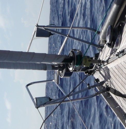

For our race “Transat Classique” Douarnenez-Agadir-Saint Barthelemy, I installed on my Swan 41 “Kallinira” a second roller with a trinquette of 35 m2. We appreciated this system starting from 25-30 knots of wind, including run wind. The only problem is the passage of large genoa during changing tack in light air.

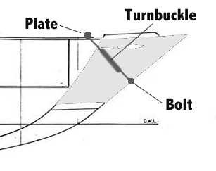

  Your second furler is attached much further aft at the deck than mine, which is attached to a deckplate bolted to the large stainless stem fitting. I like the look of yours, as there is less interference between the genoa and jib.
  Could you please give some details of the deck fitting, also a photo if possible. How do you tension the stay?

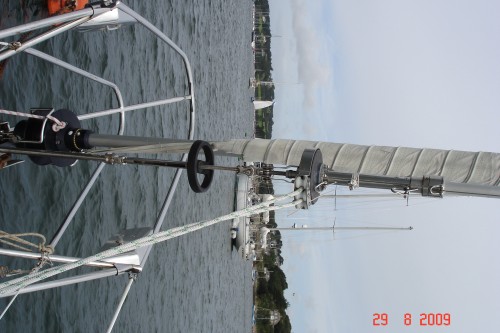

Dear Cosmolittle,
Attached a photo and a picture showing details of deck fitting of my second furling.
Tension of stay is always the same.
Yvon
