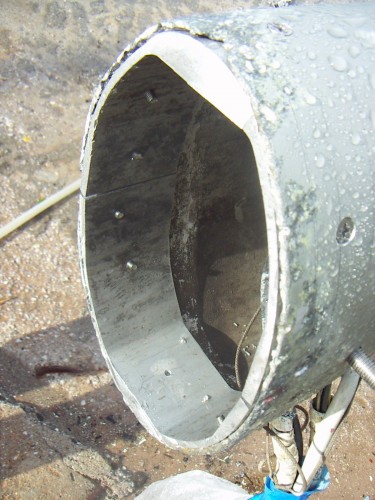

Hello,

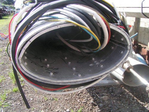

We are replacing our rigging and have taken the mast of.  The yard has warned us that there is little corrosion at the bottom of the mast.  He is proposing three solutions to be discussed: do notthing, cut 2cm of the mast and option1: put a plate 2cm thick below the mast, option 2 introduce in the mast an aluminium protection with rivets.
Anybody with experience in this matter?
Ludovic
24 September 2009 - 02:03
I had a similar issue about 15 years ago with the mast on my Swan 41. I think I went for your 3rd option which was to slieve the bottom of the mast which seemed to work very well. It was done for me by Proctor masts (now defunct) who had a mobile service unit who did a couple of other jobs on the mast and boom at the same time in the Hamble boatyard.
After having it done I made very sure that I kept the drains from the adjustable mast step clear so that this area stayed as dry as possible.
Gavin
24 September 2009 - 21:31
This is the way the mast of my 411 was fixed 7 years ago: your 3rd solution.
I reckon it was not a perfect job as I would have preferred a better fit of the insert and more rivets but good enough.
Daniel, 411-004
25 September 2009 - 07:58
Join Date: 25 July 2008
Posts: 32
Thank you to both of you, I think indeed that fitting a piece inside seems the best solution.  In this case I beleive the best is not to cut the mast but probably just clean it very well and ad the piece inside.
Ludovic

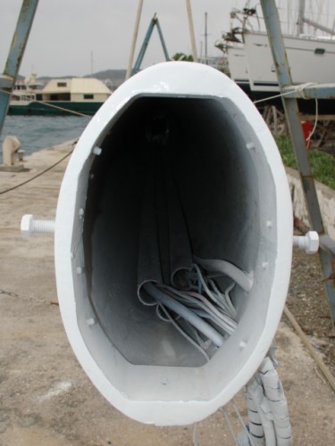

Dear Christophe,

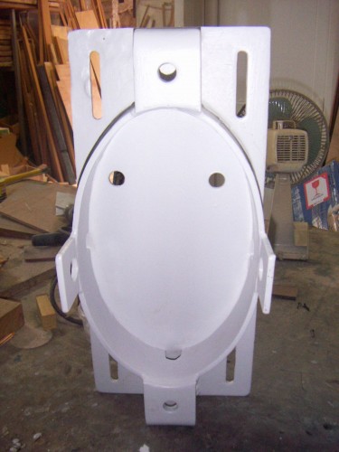

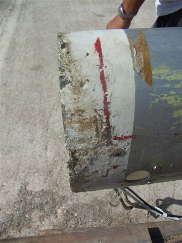

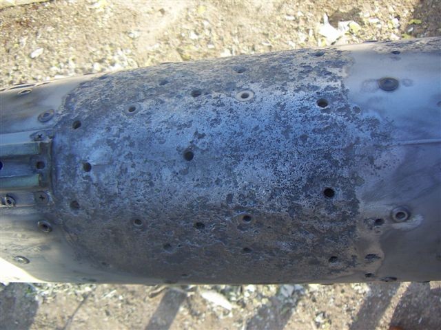

After some work this is how the bottom of the mast looks like.
I would not fit a staineless steel piece in the mast as you will have even faster corrosion but an aluminium piece.
I cleaned my shoe mast and did two holes in the middle so that the water trapped inside the mast can leave.  I even plan to rince with fresh water inside the mast at the end of holiday season.
Did you check the keel bolts below the shoe mast? (see the post on this issue)
Ludovic

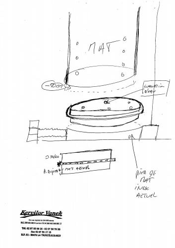

Kervilor Vanek who are working on the boat are recommending that the mast be cut and a specific piece of stainless steel be inserted inside the mast. They have mentionned the holes to prevent water from staying inside the mast. I have attached the drawings that were sent to me. Has any one any piece of advice?

Christophe, as already mentioned, I would strongly discourage adding stainless steel parts in contact with aluminum. Indeed it looks that your mast was already fixed and presently it does not need much intervention.

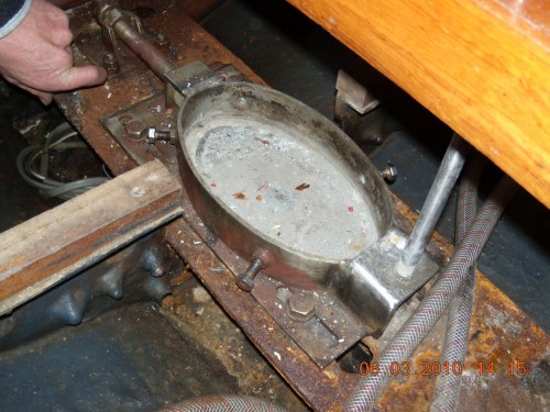

One of the question I still have is that apparently the shoe mast is stainless steel. It is by definition in contact with the mast, in aluminium. Is there any trick that I have missed?
Best regards.
Christophe
15 March 2010 - 10:03
Christophe,
yes, you are right: the shoe (the mast step) is made of stainless steel and, in fact, it is the main reason for mast lower end (heel) corrosion in the presence of water. I do not have a reply for your question but I remember a previous discussion. I think that the best solution would be insulating the two metals but there are at least two problems: 1) lightning grounding and 2) extremely high pressures. While the first can be solved with a well studied additional electrical link, I do not see an easy and durable way to solve the second issue.
The best palliative is keeping the parts as dry as possible but it is a condition hard to maintain in the long run.

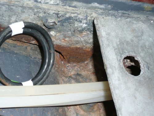

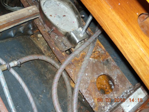

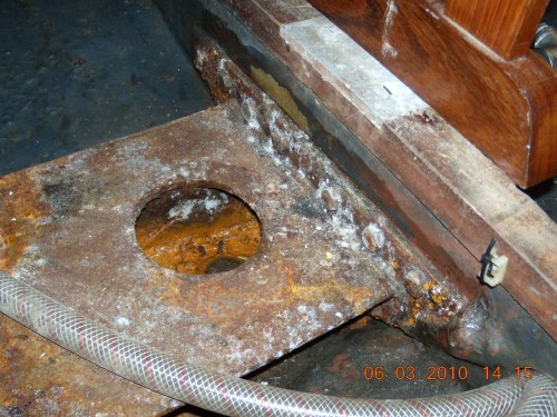

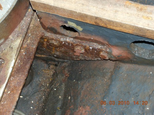

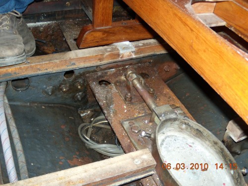

I still have a question on the piece of metal which lays underneath the shoe mast. I have attached some pictures which show rust. We will sand it and clean it but I am not sure this will be enough to do the trick. It seems that removing this piece of metal is quite a job. I was wondering if any one of you has had similar experience or has any good piece of advice for me.
I have liaised with Nautor Spare parts to find out if they can still provide a replacement of this piece and am still awaiting their response.
Best regards.
Christophe

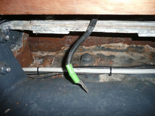

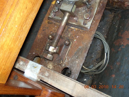

Further pictures

I had the same problem onboard Only You, and this winter I had the mast step cleaned, got rid of the rust, and as the "fresh" steel appeared I had it coated with a special paint.
Below some pics of the condition before and after.

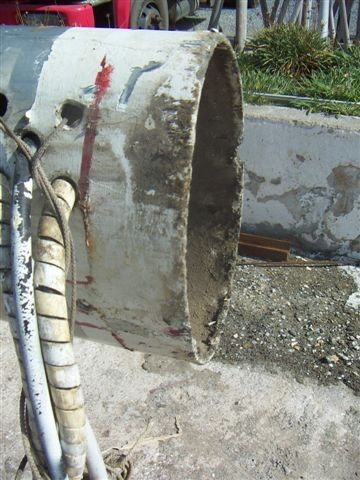

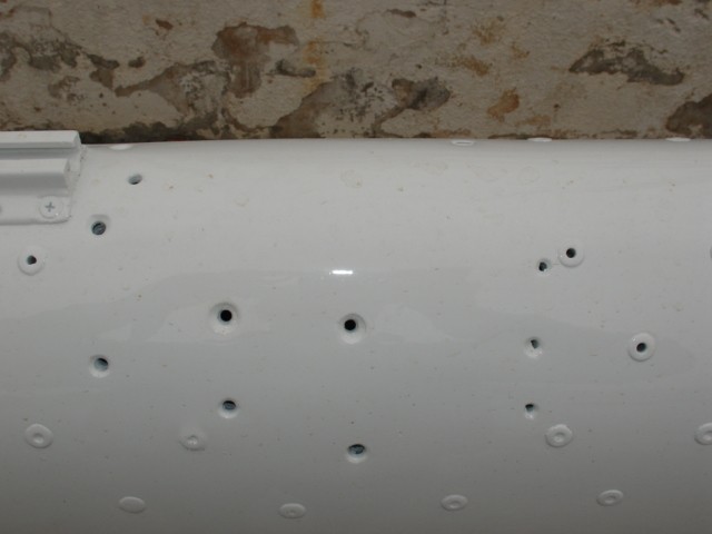

In 2012 we sanded our original mast and discovered the mast corrosion at the gooseneck and kicker stainless junctions plates.  We cleaned, filled with specific material and painted the mast.  The situation is showed on the two pictures.
The idea was that if we could avoid contact between aluminium (the mast) and staineless steel we would be safe.

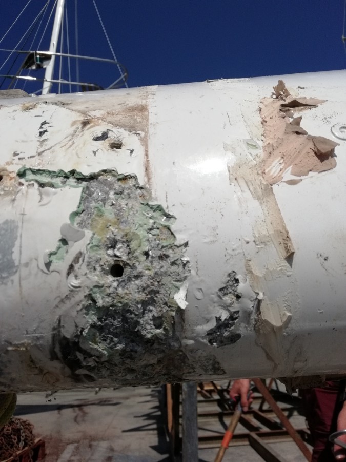

Very quickly (one two years) we could see some corrosion bubles below the staineless steel plates and therefore we decided to have a new check of the rigging during the winter 2018.  We were very suprised to see that corrosion had continued with a worsening of the situation.
Ounce again we were advised to strongly isolate the two material and had a new painting of the mast.
See next post for the following observations
Ludovic from Rumtrader (swan 47)
situation winter 2011-2012 after sanding the mast
Situation winter 2011-2012 after isolation and painting
Situation winter 2018

The work done in 2018 did not prevent corrosion to continue its destructive work.  In winter 2023-24 we had a new look (see picture) and it becam clear that if I wanted to keep the mast a new strategy was needed.
After discussing at the Swan boot at Dusseldorf and with some rigger I reached the conclusion that nothing can stop the corrosion between aluminium and staneless steel.  It is even worse when there is an isolant between the two materials as electron exchange will even be more important.
The best is to never paint the mast.  I have indeed seen some original mast never painted that seems to have less problems.

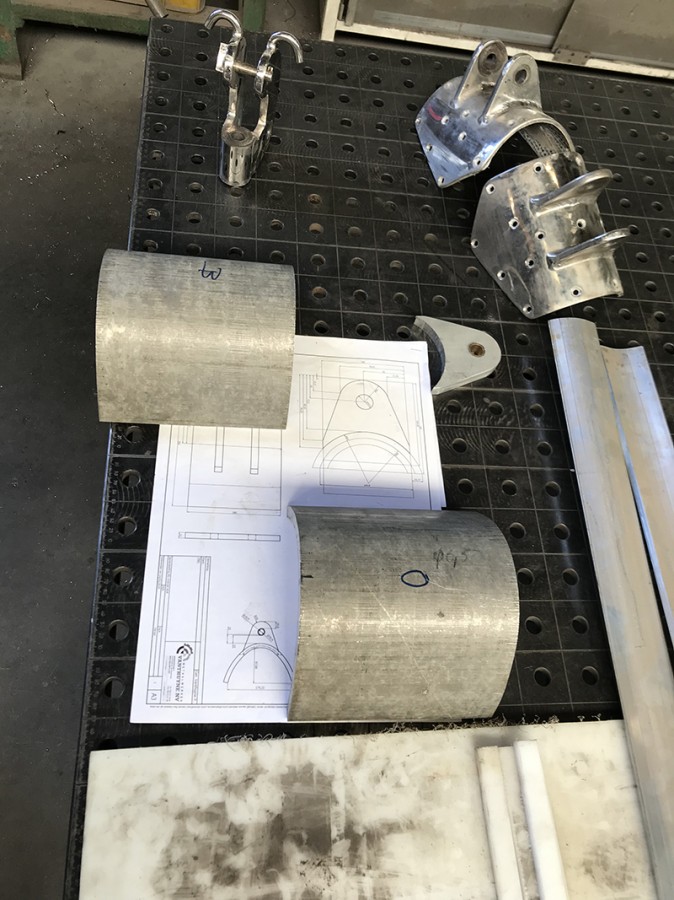

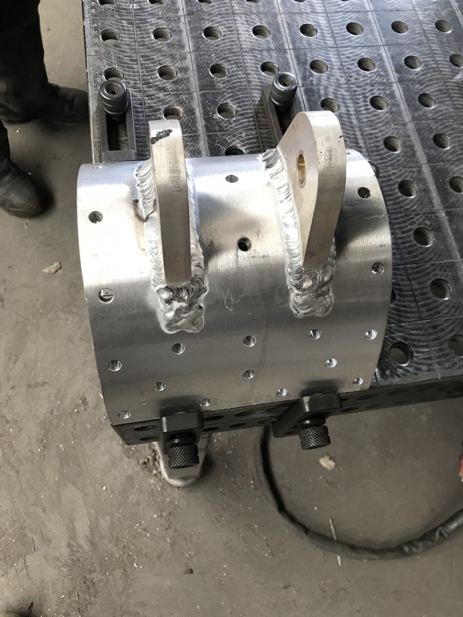

With the boat yard we decided to replace the staineless steel by aluminium (see pictures).   The thickness and the contact area were increased and special wearing rings were produced so that the staineless steel axis would not be in contact with aluminium.
The plates were fixed by aluminium rivets.
After one year I can only be positive on the solution, we will modify to Monel rivets this year.  I feel more secure and when I walk to the mast it is a great satisfaction to see these two new items.  Off course the original plates are here at home and will join the box of all original sparepart of our Swan.
Fair wind to all of you.
Ludovic form Rumtrader
gooseneck plate
gooseneck plate finished
