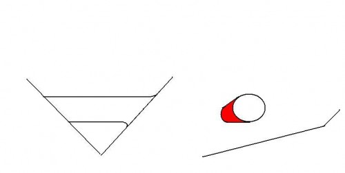

Some additional suggestions.
The tunnel ends should be rounded off all around the circumference as shown at the left end.
There is an alternative to building up thickness in front of the tunnel, i.e. to make a recess aft of it, so deep forward that the front edge is not visible from straight forward, and tapering off aft, as shown by the red area.
 Meilleurs salutations
24 January 2010 - 13:49
PS
Right end, sorry !

Bien le bonjour mon cher Lars.
Thank you for your accurate suggestions and added clarifications. In my case here are more specific data for your kind consideration:
1-I will have more than 300mm of water (to the water line) above the tunnel, that is more than its diameter, which 250mm. This is ideal according to the manufacturer.
2-I will have a little more that 1/2 the tunnel diameter under the lower edge of the tunnel to te rounding of the hull. This seems OK (?) since the minimum required is 1/3 of the tunnel diameter under it.
3-The tunnel length will be about 3 times the tunnel diameter, thus staying within the ideal of a length 2 to 4 times the diameter.
4- I understand that the best solution to reduce the drag and to increse (or keep) the efficiency of the thrust power is to make a recess in the hull at the back  of the tunnel. True. However, this is what is being done on newly build boats, facilitating the casting of the recess. I imagine - I am not sure - that this operation might be quite difficult on an existing hull. Thus the recess, in order to be efficient, must corespond to about 10% of the diameter of the tunnel: ca 25 to 30mm! What about the hull thickness on this area as well as many other considerations that come to mind? Therefore, I will probably - unless you prescribe otherwise - go for a deflector in front of the tunnel.
Wecome with your comments and meilleures salutations amicales.

Mon cher Philippe
If the tunnel installation is fine according to the manufacturer it is not worthwhile to enter into further discussions.
It is suggested that you measure the achieved thrust in due time, would be of interest to compare with the manufacturer's figure.
The arrangements outside the tunnel for reducing drag do not affect the achieved thrust. If the recess is made aft it will go through the laminate, and require additional lamination work. Much easier to make an outside deflector forward.
It is suggested that you consider the use of epoxy resin for the lamination work, and take care to overlap the laminations properly, the tunnel must not come loose under any circumstances. If the manufacturer allows the motor to be horizontal this position might occupy less space in the interior.
