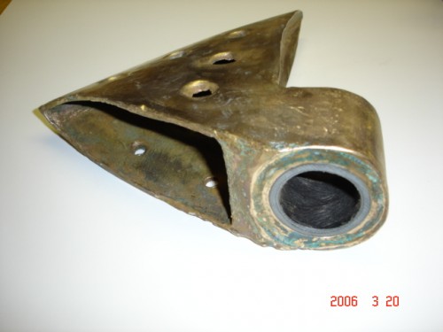

I recently completed the overhaul of my Swan 43 rudder and used a fiber-reinforced plastic material that is machinable to custom size.  I ordered this bearing from GGB Bearing http://www.garlockbearings.com.
I used their GAR MAX series and it is working well.  It has been dimensionally stable and I was able to machine the outside diameter for a press fit into the cast bronze shoe supporting the bottom of the rudder post.
I will be posting this on the Swan 43 maintenance web soon.
