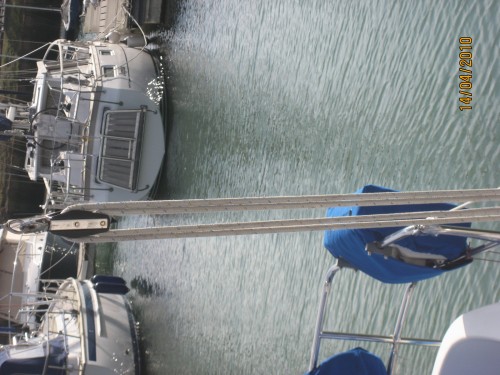

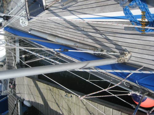

Detail make up of the running backstays
I am ready to buy - I am thinking of 11.5 m of 4mm 1x19 wire to a norseman or similar 5/16 fork to the mast fitting. On the other end, maybe swage the wire over a thimble, onto which a swivel is placed, with 25 feet of T900 polyester line, low stretch, 3/8. spliced onto the swivel. I like the swivel to prevent any wind up, the downside is I have an inseparable runner so when not in use, I cannot detach the line from the wire, the whole thing has to stow at the mast or wherever.
Or is that too complicated - ? I could just tie the line to the thimble, there's plenty of breaking strength available to give up some strength in the knot, or use a j-lock shackle or similar to bring the line to the wire, which would allow me to break the joint - any details on how the runners were made originally, or how anyone has made them better would be appreciated -
Sorry for beating this horse to death - but soon I will be off the topic.

Well, I bought them today finally.  The rigger told me that while I was using wire, (the mast fitting wants a fork, so wire is the way to go if you don't want to change that around), the loop and thimble is fine, so I went that way, removed the swivel as the shackle has a swivel half built in.  So anyway, I will have the runners next week and try them out.  Just over $700 US for the pair, as described.
