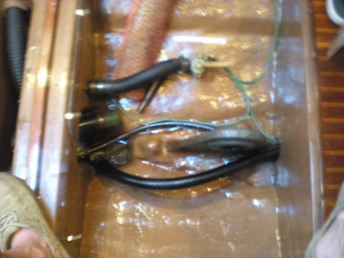

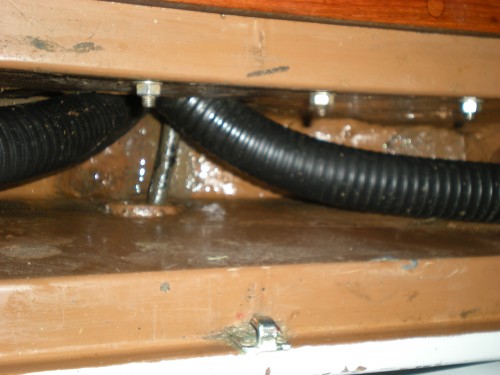

Was up to the boat this evening - found some crud in the bilge I had to clean up before trying the dye pen test, also had anti freeze in the sump below the engine, which I suspect got there from a yard guy not cleaning up after himself, so I cleaned all that up, then the bilges were a little too wet for the test - so sometime tomorrow or the next day I will dry her out really well, and try that test. My observations just looking were that there's no sign of anything moved, cracked, etc. but I will go all the way and try the dye pen and make sure. I attach a couple shots of the after area of the keel - I will also look at the forward area, although my reading points to first damage for a keel strike at the nose/front bottom of the keel will be in the after area of where the keel is attached to the boat - so I guess this is just an update, unless you see anything in these pics that makes you think of something....
Geoff
