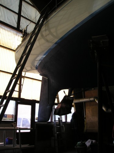

From my research I understand one boat, 'Aries' has had her rudder modified to a design by Bill Langan (see file attached). It would be interesting to hear what her owner thinks of this modification.
