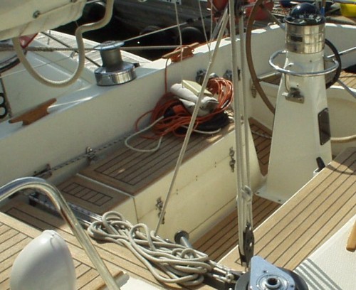

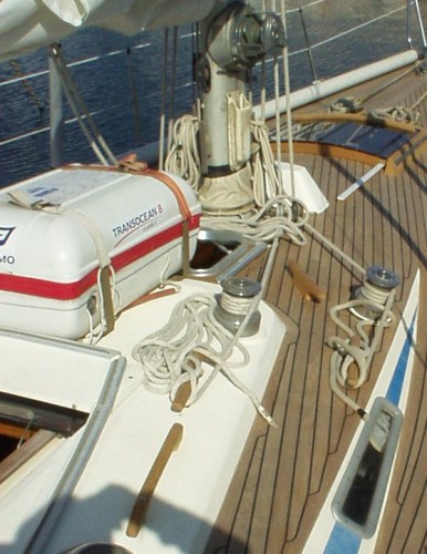

on our 41/022 we have modified the original space for the liferaft into a place to store mooring ropes, and bought a standard zodiac liferaft in a canister which is stored on the roof via a stainless steel structure, between the central hatch and the companion way' hatch. There is just enough space when the hood is raised, to be able to open the central hatch.
The modification to the cover consisted in cutting the vertical part, bolting it to the boat, and adding hinges to the horizontal part.
Hope this is clear (sorry for my poor technical english!). Can send you pictures if needed (but not before january).
Kind regards.
Philippe.
04 December 2010 - 11:52
Christophe,
I foud two pictures in my PC which could help. At the time our liferaft was a Plastimo, now a Zodiac with identical dimensions.
Kind regards. Philippe.
